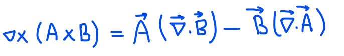

Identify true and false.
Vector calculus.
Can someone tell me if i am wrong ?
Numbers 2, 3 & 4 are ambiguous without parentheses. Also, please state why you think each one is True or False. You might be right for the wrong reason.
True according to BAC-CAB
True because in scalar triple product we can change "dot" and "cross"
False. If nabla was only a vector it could be right. But here it should take the derivate of both A and B vectors.
This is also wrong with same reason. If nabla was only a vector it could be right. But here it should take the derivate of both A and B vectors.Sorry that I can't use latex right now.
Should it? I don’t see why.
But is there a more obvious reason it is wrong?
Likes PeroK and MatinSAR
Are you sure? Note that on the left-hand side ##\nabla## operates on both ##\vec A## and ##\vec B.## On the right-hand side it does not.
Likes MatinSAR
False. On the LHS the derivative acts on both A and B and in the RHS you suddenly skip the derivative of one field in each term.
Generally you seem to be treating ##\nabla## as if it were a vector. It is not. It is a differential operator.

Sorry but I cannot find out which one you are talking about. 3rd or 4th? Or both of them?
Agree. I did not notice it.
Yes. So I can't use triple dot product or triple cross product rules when I have a differentiel operator. Am I right?
Thanks everyone for their help and time.
You can, to some extent, but you must make sure that you respect what the differential operator acts on. There is a way of doing this formally using vector identities and the Leibniz rule. Using a notation such that it is clear what the differential operator acts on, you can do any manipulations of the vector structure as long as you end up with a proper expression in the end. For example, take ##\nabla\cdot(\vec A \times \vec B)##. Using underline on a vector to denote that it is what the nabla should act on, this can be written
\nabla\cdot(\underline{\vec A} \times \vec B)
\nabla\cdot({\vec A} \times \underline{\vec B})
where we have applied the Leibniz rule. You can now perform any manipuations you wish on the vector structure with the aim of having the vector the operator acts on as the only thing to the right of it. In particular, here we would do
\vec B \cdot (\nabla \times \underline{\vec A})
for the first term by cyclic permutation of the triple product. Once on this form the underline can be removed as it is clear what the differential operator acts on.

Then you swap the "vectors" between the parentheses, but when you do this, you must change the sign as demanded by the cross product in the original expression.
Sorry but I don't understand why the sign should change. I have changed the sign and I get:
$$\vec{\nabla}\times(\vec A \times \vec B) = -(\vec B \cdot \vec {\nabla})\vec A-\vec B(\vec{\nabla}\cdot \vec A)+\vec A(\vec{\nabla}\cdot \vec B)+(\vec A\cdot \vec{\nabla})\vec B$$
But then I did not change the sign and I get same result as arfken mathematical methods for physicists. Can't we say that according to ##\vec A.\vec B = \vec B.\vec A## the sign does not need to change?

kuruman said:
You are mixing examples.
In Example 1 the swap of symbols ##A## and ##B## has even symmetry because $$~\vec{\nabla}(\vec A \cdot \vec B)=\vec{\nabla}(\vec B \cdot \vec A).$$ This means that when you have something like ##(\vec{\nabla_A}\cdot \vec B)\vec A## and you need to swap to get ##\vec B## out of the way, when you swap, you must preserve the even symmetry and write $$(\vec{\nabla_A}\cdot \vec B)\vec A\rightarrow+(\vec B\cdot \vec{\nabla_A})\vec A$$In Example 2 the swap of symbols ##A## and ##B## has odd symmetry because $$~\vec{\nabla}(\vec A \times \vec B)=-\vec{\nabla}(\vec B \times \vec A).$$ This means that when you have something like ##(\vec{\nabla_A}\cdot \vec B)\vec A## and you need to swap to get ##\vec B## out of the way, when you swap, you must preserve the odd symmetry and write $$(\vec{\nabla_A}\cdot \vec B)\vec A\rightarrow-(\vec B\cdot \vec{\nabla_A})\vec A.$$
Thanks. But Why your answer is different from the book?
Arfken mathematical methods for physicists:
Likes kuruman
Because I led myself astray and did not follow the rules to treat the vectors properly. When you swap vectors, you change signs only when you have a "cross" and not when you have a "dot" between them. I edited my post with the two examples to fix the problem. I also deleted the post that you refer to in #21 because it was nonsense and I did not want to confuse readers in the future.
Thank you for pointing out the error of my ways.
Likes MatinSAR
