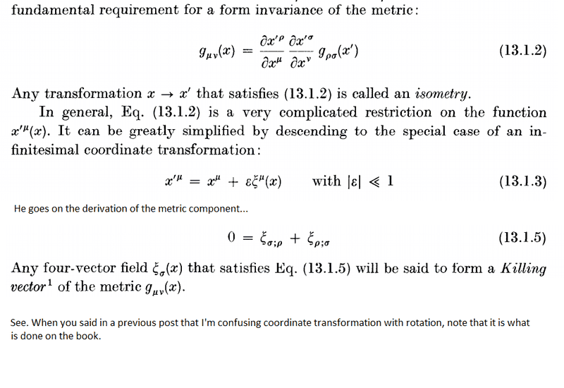

PeterDonis said:
The key thing is that no derivative of ξμξμ\xi^\mu appears in the action of the rotation. I have said this several times now but it doesn't appear to be getting through to you.
No. I understood. What I'm asking is if we can also use the derivative of (a possible) another Killing Vector to accomplish this task.
davidge said:
Is it possible to find a ξμξμ\xi^{\mu}, other than the one you've found
PeterDonis said:
Where are you getting this from?
Maybe I'm wrong, but I thought when we perform a change in the components of a vector (keeping the vector the same), one can treat this by saying that the vector changed in \mathbb{R} ^2 from a point x to a point y, where y = x + \epsilon \xi (x), |\epsilon| &lt;&lt; 1 in the infinitesimal case. In the case of a rotation, we require that \xi^{\mu} = 0 at x for any \mu, so that the point x is kept invariant.
I don't know if you've already read Nakahara's book or Weinberg's book, but if you do that, you would understand what I'm trying to say.
  • #39
Not to my knowledge.
This is treating the rotation as a coordinate transformation, not a mapping of vectors to vectors. Everything I have said so far has been assuming we are treating the rotation as a mapping of vectors to vectors. A coordinate transformation keeping vectors fixed is not the same thing, although there are similarities.
davidge said:
the vector changed in ##\mathbb{R} ^2## from a point ##x## to a point ##y##, where ##y = x + \epsilon \xi (x)##, ##|\epsilon| << 1##
Now it seems like you can't make up your mind whether you want to talk about a coordinate transformation or a mapping of vectors to vectors. I strongly advise you to take a step back and use very precise language to make sure you are saying exactly what you mean.
What is quoted just above describes mapping a vector ##x## to a vector ##y##, holding the coordinate chart fixed. If you want to describe a coordinate transformation, you would say something like: the coordinates of vector ##V^\mu## changed from ##x^\mu## to ##y^\mu = x^\mu + \epsilon \xi^\mu##. Here ##\xi^\mu## is describing a coordinate transformation (in the particular case we have been discussing, it would be one that rotates the coordinates about the origin, i.e., changes ##\theta## but not ##r##, in the opposite sense to the sense that we would view the mapping of vectors to vectors as rotating a vector).
Likes davidge
  • #40
This wouldn't for one thing, we are keeping the point fixed, that is to say we are keeping the coordinates the same as before.
PeterDonis said:
What is quoted just above describes mapping a vector xxx to a vector y
I think you are misunderstanding my notation. Here both x and y denote points in \mathbb{R} ^2 and not vectors. Also, I noticed that you are treating V^{\mu} as a vector. Actually it is the component of a vector ##V##, i.e $$V = \sum_\mu V^{\mu}(x) \frac{\partial}{\partial x^{\mu}},$$ where ##V^{\mu}## is allowed to be a function of ##x## at a point ##x## in ##\mathbb{R} ^2##.
  • #41

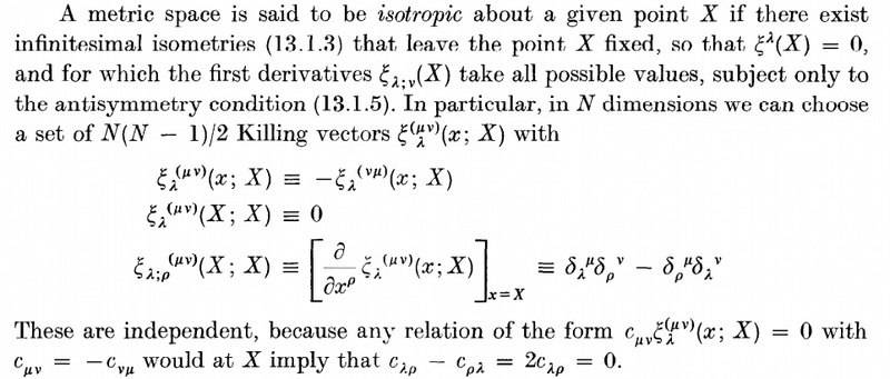

  • #56
PeterDonis said:
So what? As I've said a number of times now, the derivatives of the KVF have nothing to do with generating rotations
Because I found that at least on ##r = 0## we cand find vectors ##\xi^{\rho}## that leave the point invariant and that obey Killing's equation:
##\xi^{r} = \xi_{r} = \xi^{\theta} = \xi_{\theta} = 0##, ##\partial_{\theta} \xi^{r} = 0##, ##\partial_{r} \xi^{\theta} = \frac{1}{r}##, and so
##V'^{\theta} = V^{\theta} + d{\theta} (\partial_{r} \xi^{\theta})V^{r} = \theta + d{\theta}##,
##V'^{r} = V^{r} + d{\theta} (\partial_{\theta} \xi^{r})V^{\theta} = V^{r} = r##.
These are not the Killing Vectors you wrote down in a previous post, because those were obtained from metric relations.

  • #57
davidge said:
I found that at least on ##r = 0## we cand find vectors ##\xi^{\rho} ## that leave the point invariant and that obey Killing's equation
This doesn't make sense; ##r = 0## is just one point, and the vector ##\xi## vanishes at that point; but if you are only taking into account one point, derivatives are meaningless (you need at least a neighborhood). And at the point ##r = 0## it is also meaningless to talk about "rotating" ##\theta## to ##\theta + d\theta##, since the coordinate ##\theta## is singular there.
Why are you persisting with trying to use derivatives of Killing vectors instead of Killing vectors themselves? That is not done anywhere in the literature that I'm aware of. If it's just your personal thing, then (a) it's not going to work, and (b) PF has rules about personal theories, which you should review.
Likes davidge

  • #59
As I said before, I'm following what I learned from Weinberg's book and some two or three notes I found on web. (Also from a lecture I attended last month at the university.) Maybe I misunderstood what I've read?
PeterDonis said:
at the point r=0r=0r = 0 it is also meaningless to talk about "rotating" θθ\theta to θ+dθθ+dθ\theta + d\theta, since the coordinate θθ\theta is singular there
I don't see why it is singular there.
PeterDonis said:
you used partial derivatives instead of covariant derivatives
I did not show my complete derivation in post #56, but as I mentioned, I imposed the condition that partial derivatives of them are equal to the covariant ones.
PeterDonis said:
Whereas the definition in terms of covariant derivatives works fine at r=0r=0r = 0.
I don't think so. Consult your post on the derivation of the covariant derivatives to see that at ##r = 0##, ##\nabla_{r}\xi^{\theta}## is undefined.
I agree.
  • #60
I think you must be. Unfortunately I don't have Weinberg's book to check the relevant sections for myself.
The metric is ##ds^2 = dr^2 + r^2 d\theta^2##. This metric has no inverse at ##r = 0## (its determinant is zero), because ##g_{\theta \theta} = 0## there. Saying that ##\theta## is singular at ##r = 0## is a (somewhat sloppy) shorthand for that.
You can't "impose" this condition; it is either satisfied by the coordinates you've chosen or it isn't. For polar coordinates, it isn't.
Yes, but that doesn't stop ##\xi^\theta## itself from being well-defined (and nonzero) at ##r = 0## by my definition; it's just ##\xi^\theta = 1##, like it is everywhere else (and ##\partial r \xi^\theta = 0## everywhere, including ##r = 0##). What vanishes according to my definition at ##r = 0## is the norm of ##\xi##, i.e., ##\sqrt{g_{\mu \nu} \xi^\mu \xi^\nu}##. From the metric you will see that this norm is just ##r##. Whereas by your definition, you tried to make ##\xi^\theta## itself vanish at ##r = 0##, which doesn't work.
