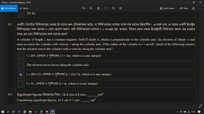

A cylinder of length l, has a magnetic field B inside it, which is perpendicular to the cylinder axis. An electron of charge -e and mass m enters the cylinder with velocity v along the cylinder axis. If the radius of the cylinder is r=mveB, which of the following ensures that the electron leaves the cylinder with velocity along the cylinder axis?
##\vec F=q\vec v\times \vec B##
##\vec F=m\vec g##?
##\vec B=\frac{\mu_0 nI}{4\pi r}##
Since the question says that "velocity along the cylinder axis" and "magnetic field perpendicular to the cylinder axis". So cross product of velocity and magnetic field becomes their magnitude.
##\vec v\times \vec B=||v|| \\ ||B||##
So
##\vec F=qvB##
##mg=qv\frac{\mu_0 nI}{4\pi r}##
At first sight my assumption was electron can leave along the cylinder axis. But when I came up with the equation, I just realized I can't find a relation of between those given options and my results so perhaps electron can't leave along cylinder axis. While posting the question I was thinking that given ##n## in option isn't related to mine. So my attempt is completely wrong.
What path does an electron take in a constant magnetic field?

Helical path is followed when velocity is perpendicular to magnetic field. But charged particle doesn't feel any magnetic force when they are parallel to each other. So velocity of electron is along the cylinder axis. I just found two new equations while watching the video ()
pitch and radius of helix. Is there anything else which I should use to solve the problem? @PeroK
Likes PeroK
More interestingly, I don't know direction of for the given problem. How can I deal with velocity direction?
I must be honest, I don't understand this question. I don't understand the equation ##r = mveB##. That's not dimensionally correct. Second, I don't where the length of the cylinder comes into the equation.
Oops yep! The equation came magically :|. It's an Olympiad question. I don't know what to do and I don't think it can be solved any way. Anyway I have asked the same question in PSE (https://physics.stackexchange.com/q/692077/323311). I have also messaged an Olympiad contestant (reached IPhO), waiting for others reply :)

First some general observations on OP's relevant equations. Gravity is not mentioned explicitly so it is safe to ignore it. The magnetic field is perpendicular to the axis of the cylinder and it may be assumed uniform. So ##\mu_0 n I## is irrelevant because, I think, the cylinder is not material like a physical solenoid but intangible like a Gaussian surface.
Secondly, the radius as given may look dimensionally incorrect, but I think ##r=mveB## is to be interpreted as a simplification shortcut in the spirit of ##c=1## which is also dimensionally incorrect.
Thirdly, apparently the Lorentz force ##\vec F=-e~\vec v\times \vec B## is the only force acting on the electron. We all know that the resulting trajectory is a circle in the plane perpendicular to the magnetic field. The electron enters the cylinder "along" but not necessarily on the cylinder axis. Assume that it does so through the "back" flat face of the cylinder. It must exit also "along" which means describing a semicircle of radius ##mveB## without crossing the side of the cylinder or going out the "front" flat face first.
Fourthly, I cannot see how one gets quantization of the cylinder length if the last assumption above is correct. All it does is result in inequalities relating the length to the radius. However, it is easy to see how one gets quantization if there is a repetitive pattern in the trajectory of the kind one gets if the velocity has a component along the field or if there is an electric field perpendicular to the field and the initial velocity.
Fifthly (at this point grasping at straws), given that this is an Olympiad question and these are sometimes tricky in the sense that they are innocent-looking but expect one to think outside the proverbial box, the original statement of the problem in the photo says that the magnetic field is "constant". This means constant in time but not necessarily uniform. However, even if one knew the spatial dependence of the non-uniform field, the problem of quantization would remain.
In short, sorry but I cannot be of much help.

PeroK said:
I must be honest, I don't understand this question. I don't understand the equation r=mveB. That's not dimensionally correct. Second, I don't where the length of the cylinder comes into the equation.
Clearly the equation should read r=##\frac{mv}{eB}##, or some dimensionless multiple of that.
We don't know which way the field goes, so we can't tell whether (initially) the force will oppose or conspire with gravity. Presumably we can therefore ignore gravity.
This leaves us with a circular path in a plane containing the cylinder’s axis.
It worries me that, other than option b, the choices seem to suggest a circular motion plus a continuing forward velocity.
Wait a minute, I suspect that was the case. I had seen Latex problem in that site earlier :). Where they usually wrote ##1021## is mass of a sun but the same value was looking ##10^{21}## in android device. :)
According to an Olympiad contestant (reached ipho), the answer is ##I=2nr##. (asked for hint)
And he have made sure that the ##r=\frac{mv}{eB}##.
The assumption might be that the electron bounces elastically off the inner wall of the cylinder. I'm not sure why we would assume that, however.
