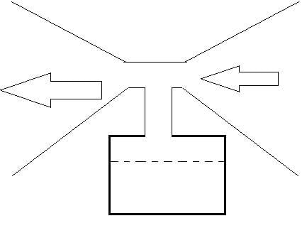

The drawing above is regarding a thought experiment of mine. Air at ambient pressure is being blown through a convergent-divergent nozzle and in the throat section, a water filled enclosed container is attached through a tube. The water container has sufficient surface area for supplying necessary LHV for the water evaporated. It's very much clear that when the air starts to flow,, the pressure in the throat section will be lower than before and that means vaporisation from the water inside the container. Now, I want to know what will be the temperature of the air after exiting the divergent section as the LHV of the steam from the vaporised air will be added to the flow. Will it be lower or higher than the initial/entry temperature? Let's assume that that entry and exit area of the nozzle is almost same.
This thought came to my mind when I am studying cold steam generation and some video on youtube regarding rotating a Tesla turbine by using cold steam in combination with compressed air flow.​

Not exactly. There is no doubt about fall in pressure and temperature due to venturi effect. I want to know what will happen when the pressure will rise again and this time with extra vapour mixed in it. Remember that the surface area of the water container is enough to supply necessary heat from surrounding atmosphere.
When you pass the throat, you will have a gas (air + water vapor) with different characteristics. Use those new characteristics to determine the changes in pressure, temperature, density, and enthalpy along the path.
To find the composition of the gas - that might vary along the path - you will need to find out first how much water is pulled at the throat and then use partial pressures.

I don't get it; is the water tank vented to external pressure?
No. Due to venturi effect, the pressure over the water is lowered and it starts to evaporate. This newly formed vapour will be mixed with flow and in the divergent section, where the velocity will be lowered and the temperature and pressure will rise again, will the temperature back to the initial/entry level or not, that's my question.
And the tank water is maintained at inlet temperature?

Your scenario is not completely described. Please state all the relevant conditions, known and unknown, at the inlet, throat and outlet of the venturi: temperature, pressure and humidity at least.
[edit]
Some thoughts though:
  • If the entering air is at less than 100% RH you will get evaporation and a temperature drop without a Venturi. That's what a cooling tower/evaporative cooler does.
  • A strong Venturi will cause both a temperature and pressure drop at the throat, which can cause condensation/icing (as @Lnewqban pointed out). It's the opposite of what you are trying to do.

The more I look at your drawing, the more I think that the water reservoir will not have the effect you expect on the relative humidity of the airflow.
If your drawing is proportionally correct (the tube connecting to the reservoir is as big as the throat diameter), then the pressure will not be as low as you might expect. The huge area change will be seen as a divergent section by the airflow and pressure will increase dramatically. The larger the tube, the more it will look like this (the airflow will probably be more turbulent over the reservoir):
If your reservoir tube is made smaller such that it doesn't disrupt the throat flow and does create a low pressure to create more water vapor, then the tube may be small enough that the water vapor flow will so small that it will not change the airflow humidity level enough to make a difference. It's basically the same effect as using a pitot tube like so:

You cannot say something like that. You are basically saying "Because the pressure & temperature will go down, the pressure & temperature will increase."
You have to take the problem as a whole by using a control volume. I would set it as the inside of the convergent-divergent nozzle, including the reservoir up to the water level. (But I would best trust @Chestermiller to select the better approach)
From there, you have two inlets (convergent part of the nozzle and the reservoir) & one outlet (divergent part of the nozzle). Whatever comes in must come out - momentum, energy & mass.
Energy-wise, there will necessarily be more out from the divergent nozzle compare to what is going in the convergent nozzle, because you say yourself energy is allowed to come in the reservoir and thus added to flow.
How that added energy will show up depends on the design conditions. It could show up as a temperature rise, a higher pressure, or a faster-moving fluid. I don't think you can get an obvious answer without solving the equations and maybe even having numbers put into those design conditions (dimensions & initial conditions). For example, will the flow reach supersonic speeds somewhere in the nozzle?

Basically everything you're saying now is wrong and contradicts what we've been telling you:
T C said:
As the pressure at the throat is lower than that of the container
The dry air pressure at the throat is equal to the dry air pressure in the container. The [water] vapor pressure may be higher, lower, or the same based on conditions you haven't specified.
T C said:
...some vapor from container will enter into it.
Maybe, depending on the conditions you haven't specified.
T C said:
After entering there, some condensation will occur as the pressure and temperature there is lower.
No, and no. The pressure drop happens before the container, so you get one or the other (evaporation or condensation), but not both.
To put a finer point on it, I see three scenarios, with the second being the boundary between the other two:
1. Low humidity entering air results in evaporation from the container.
2. Moderate humidity entering air results in saturated air in the Venturi and no evaporation from the container.
3. High humidity entering air results in condensation/icing into the container.
[Note: I have a vision of what the boundaries of the problem are, and if someone pictures something outside that there may be differences. For example, if we get into supersonic flow.]
You need to start trying to absorb/learn what we're trying to teach you and not just cling to your initial idea, accepting only validation in response.
