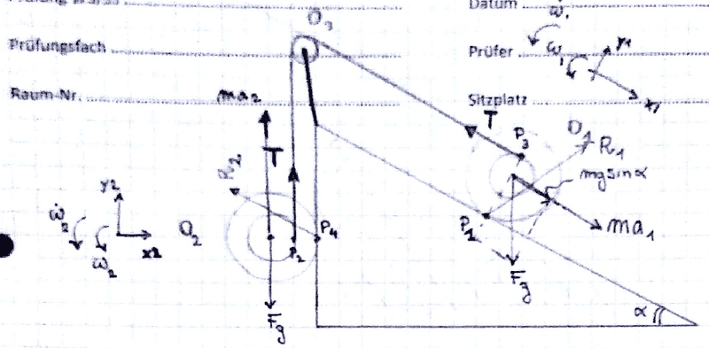

In summary, the problem is finding the acceleration of the two wheels (rolling without slip, in particular in point P4) and connecting them with a not extendable rope. The wheels have different radii, the internal radius where the rope is rolled up is 10 cm, and the weight of each wheel is 1 kg.
parmalesso
1. The problem is the following:
Starting from stillness @ t = 0, we are looking for the acceleration @T=0 of the 2 wheels (rolling without slip, in particular in point P4 we have a gear wheel contact so we can have that the reaction R2y of the plane could be also in direction y2, in this case, you can see that Reation R2x in direction x2 the reaction is 0).
The 2 wheels are connected with a not extendable Rope. Also Wheel 1 does not slip, so R1y = mgsin(alfa) with alfa = 30°, whereas R1x should be found.
the big radius of each wheel is R=20cm
The internal radius where the rope is rolled up is r = 10cm.
J of each wheel is 0.0125 kgm^2.
Weight of each wheel m = 1kg
domega1 = - a_o1 / R ; % Angle acceleration wheel 1 ( positive domega1 in clockwise direction)
domega2 = - a_o2 / R ; % Angle acceleration wheel 2 (positive domega2 in clockwise direction)
eq1 (Forces equilibrium direction x1) : m * g* sin(alfa) - T + R1x = m * a_o1 ;
eq2 (Momentum equilibrium around P1): ( J + m * R^2) * domega1 = T * (R+r) - m * g *sin(alfa) * R - m * a_o1 * R ;
eq3 (Forces equilibrium direction y2): - m * g + T + R2y = m * a_o2 ;
eq4 (Momentum equilibrium around P4) : ( J + m * R^2) * domega2 = m * g * R - m * a_o2 * R - T * (R-r) ;
eq5 (cynematic relationship) : domega2 * (R-r) = domega1 * (R+r) ;
Looking for:
a_01
a_02
T
R2y
R1x
I solve it with Matlab and i got a_02 about -23 m/s^2 which is in my opinion not acceptable.
What do i do wrong?
Thanks in advance!
Can you explain why you included the last term on the right side?
Did you mean to say counterclockwise here? Your diagram indicates that positive direction of rotation for both wheels is counterclockwise.

Because i am a idiot! As i saw now, I wrote erroneusly and to some extends accidentally into both Momentum Equilibrium equations the "resulting forces", i will correct the equation s and come back to you.
YES I meant counterclockwise, the equations are positive in the counterclowise , i.e. coherent with the diagramm.
I solved it. I rewrote the equations:
domega1 = - a_o1 / R ; % Angle acceleration wheel 1 (positive domega1 in counterclockwise direction)
domega2 = - a_o2 / R ; % Angle acceleration wheel 2 (positive domega2 in counterclockwise direction)
Equilibrium of the Forces for wheel 1 along x1
Equilibrium of the Moments for wheel 1 around P1
( J + m * R^2) * domega1 = T * (R+r) - m * g *sin(alfa) * R ;
Equilibrium of the Forces for wheel 2 along y2
Equilibrium of the Moments for wheel 2 around P4
( J + m * R^2) * domega2 = m * g * R - T * (R-r) ;
Cinematic Relationship
And I obtain:
R and J are given:
R = 2 * r;
J = 5/4 m r^2
therefore:
T = (g*m)/2
a_o1 = -(4*g)/21
a_o2 = -(4*g)/7
R1x = -(4*g*m)/21
R2y = -(g*m)/14
That all looks good to me. Nice work.
