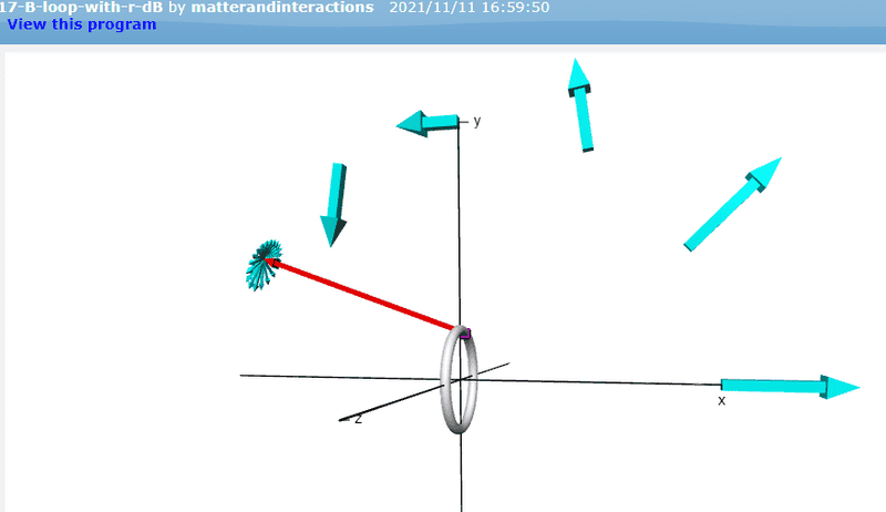

Possibly useful:
https://www.glowscript.org/#/user/G...andinteractions/program/MatterAndInteractions
  • 17-B-loop-with-r-dB

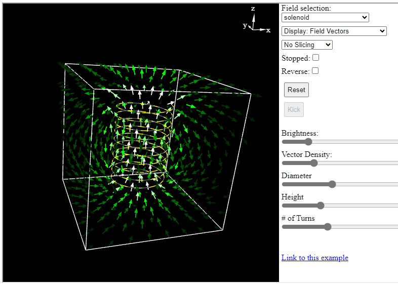

https://www.falstad.com/vector3dm/

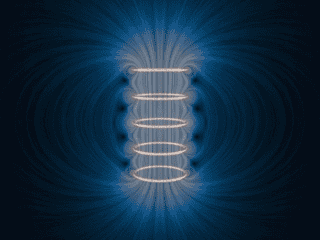

https://web.mit.edu/8.02t/www/802TEAL3D/visualizations/guidedtour/Tour.htm#_Toc27302357
Likes SredniVashtar
...and of course the winner had to be MIT.
I remember seeing those figures years ago. The page you linked is crammed with knowledge.
So, it seems they use a mixed 2D-3D representation: the object (the coils) is in 3D, while the streamlines - actually they call it 'grass seeds' and 'iron filings' lines - are shown in the saggital plane. This prevents the cramming of 3D field lines as seen in the Falstad simulations (which are good, don't get me wrong!)
In the MIT figures there is a mix of streamlines with their own alternating intensity (to show individual lines), and an overall intensity of the plot associated with the magnitude of the field (hence the disappearing into darkness - which is the part I am interested in).
A plot like this in the saggital plane and another one in the azimuthal plane should give a clear and intuitive view of the field.
Now, the problem is how to alternate the color of streamlines in order to get these 'grass seeds'/'iron filings' lines.

I have played around with Falstad's simulations and it seems there's a problem with the toroidal solenoid. It seems it shows the A lines instead of the B lines.
https://www.falstad.com/vector3dm/v...&a1=46&a2=14&a3=100&rx=72&ry=7&rz=-4&zm=1.657
Strange because at one point I had the B lines inside the solenoid in white and nearly dark outside, as expected. But now I just can't get what I expect (and what is expected by theory). Does it happen to me alone?
The linear solenoid seems fine.
