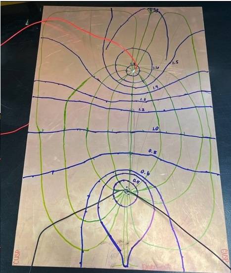

I am working with HS students on measuring Current Gradients in Copper for their science project " Current Gradients in the human body during surgical cauterization". Next year I was thing of putting a thin sheet of
Copper over strong magnets and using the Voltage gradient to draw the Current path. So, in a static setup with 5 Amps flowing through 1'x1' sheet of Copper with half of it placed of magnets will the Current path be distorted?

Dc2LightTech said:
TL;DR Summary: will the Current in a thin sheet of copper be distorted as it passes over a strong magnet.
Yes. But Cu is so conductive that it won't generate much voltage. That will be a very difficult measurement. Try to use a material that is resistive. Even then this is a difficult experiment, I think.
Check out "Hall Effect".
in the picture I posted for voltage gradients, I have 4 amps at .2volts in the cu plate, would the gradient be distorted by neodymium magnets if only on the right side. I would buy them if it would be measurable difference.
