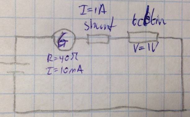

The original galvanometer measure is V = I R = 10 mA * 40 Ω = 0.4 V. Now we need to change this measure to 1 V. Right? And since it is a galvanometer (or an ammeter), we need to R = V / I = 1 V / 10 mA = 100 Ω in parallel to the galvanometer. Is this correct until this point?
Not sure about the shunt though.
Clue: the word "parallel" is not correct.

You are correct about needing a total resistance of 100 Ω in order for 1 V across it to cause 10 mA of current. So you need to increase the resistance from 40 Ω to 100 Ω.

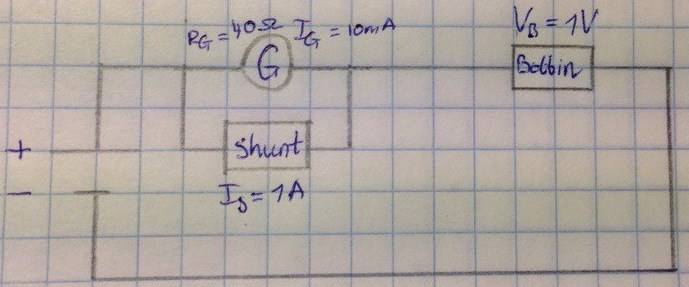

This is how I see the problem:
We have a galvanometer with resistance 50 Ohm and current 10 mA. A shutn of 1 A and a bobbin of 1 V. What am I missing here?
You seem to have missed a key point. For an ammeter, you need a shunt which is a low resistor in parallel to the galvanometer in order to allow most of the current to bypass it. For a volt meter you need a resistor in series with the galvanometer in order to limit the current to just the amount needed.
This should be correct:
That's the right layout now. The shunt resistance should be such that when 1A flows in parallel through the combination of galvanometer and shunt, the current through the galvanometer is 10mA. The bobbin resistance should be such that if the shunt were not connected, the current through the galvanometer would be 10mA when there is 1V across the combination of galvanometer and resistor. You should then be able to determine the answer to the original question.
