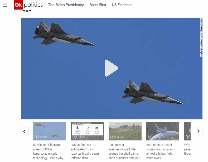

Those don't look like US fighter jets that I'm familiar with (but I could be wrong). Who is launching these US hypersonic missle tests?
https://www.cnn.com/2022/07/13/politics/us-hypersonic-tests/index.html
(CNN)The Pentagon carried out successful tests of two different hypersonic missiles systems recently, the US Air Force and Defense Advanced Research Projects Agency (DARPA) announced Wednesday.
The AGM-183A Air-launched Rapid Response Weapon (ARRW) had its second consecutive successful test on Tuesday after a series of testing failures earlier in the program. An Air Force program, the ARRW is a boost-glide system that uses a rocket to accelerate a missile to hypersonic speeds before releasing a hypersonic glider which coasts toward the target at speeds in excess of Mach 5.
They are Russian.

That's supposed to be a Russian Kinzhal on a MiG-31
BBC
Definately Russian MIG 31's.

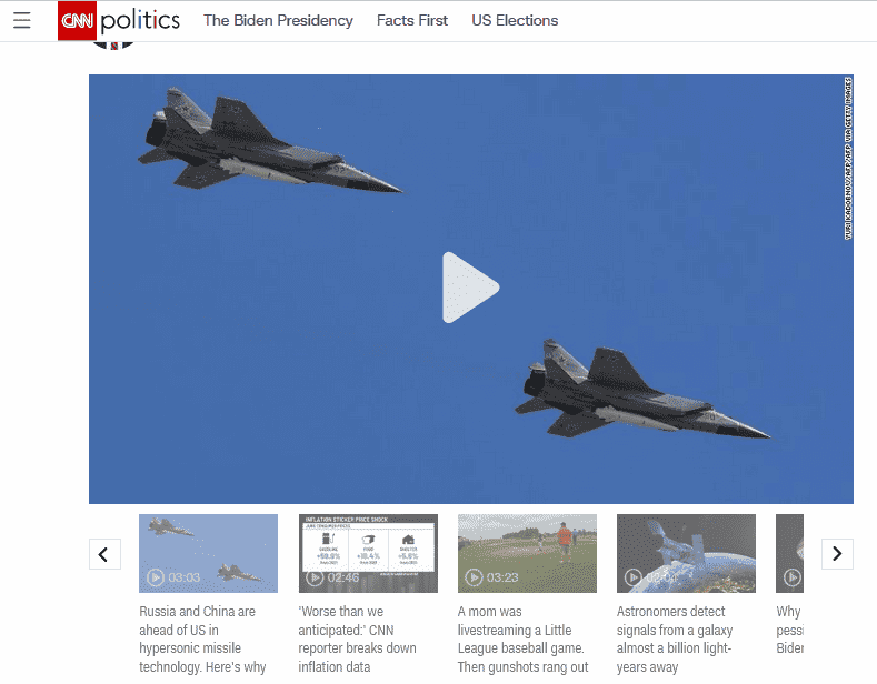

Those are MiG-31K jets carrying Kh-47M2 Kinzhal aero-ballistic missiles. They're the light beer of hypersonic missiles and you could argue they don't really qualify. But pictures like this exist in the public domain so that photo gets used a lot.
This is my new favorite way to describe the Kinzhal (really just a theater ballistic missile with modified guidance strapped to the bottom of a jet).
