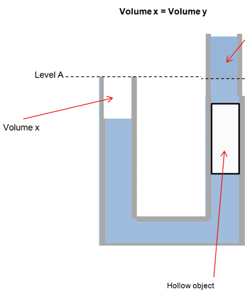

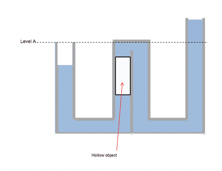

In the diagram I included, I was curious as to a this situation.
The columns of water are all connected and there is a hollow object that is buoyant and it's walls hug up against the walls of the left side of the 2 middle columns so that no water cannot pass between the two walls --- the hollow object can slide up and down the column.
My question is - since the far right column has a higher height of water (thus higher pressure), in a normal situation (without the hollow object present) the water on the right will push through to the left column and the water in the far left column would rise to the level "A". But with the hollow object placed where it is -- there is no difference? Even though the object is hollow, it will be pushed down by the greater water pressure on the far right column until the water in the left column rises to level "A"?
Your last sentence is correct. The difference between the water pressure on the top of the object and that on the bottom will move it until the two ends are at equal levels.
In fact, it will overshoot so that the left end water level will go a little higher than the right. It will then come back, undergoing damped oscillation around the equilibrium point, but friction will ensure it soon settles at the equilibrium point.

I don't think that's right for all cases and there are no numbers quoted in the problem.
The presence of the buoyant 'piston' must have an effect. Equilibrium will be reached when the three forces on the piston (two pressures and its weight) sum to zero. The left hand U situation and the right hand U situation are both affected by the presence of the piston. The solution to this problem can only be 'proved' by actually working it out, I think.
For a massless 'bubble' in place of the piston, equilibrium would be reached when the difference between the heights in the left hand section is equal to the difference in heights in the right hand section. Forces on the top and bottom of the bubble will be equal and opposite. That will depend on the detailed column and bubble lengths.
On the subject of the damped oscillation, the details will depend on the viscosity, friction, liquid density and tube diameter. The damping will be strong, in any practical situation.

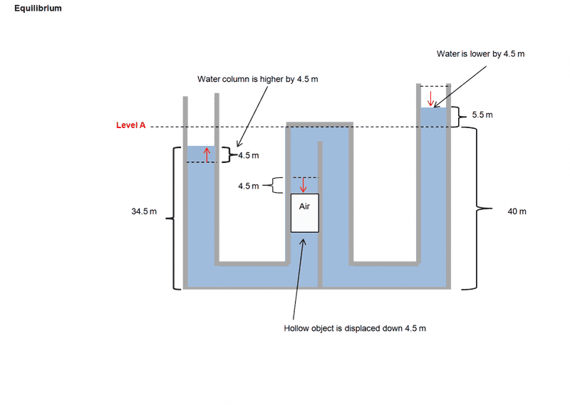

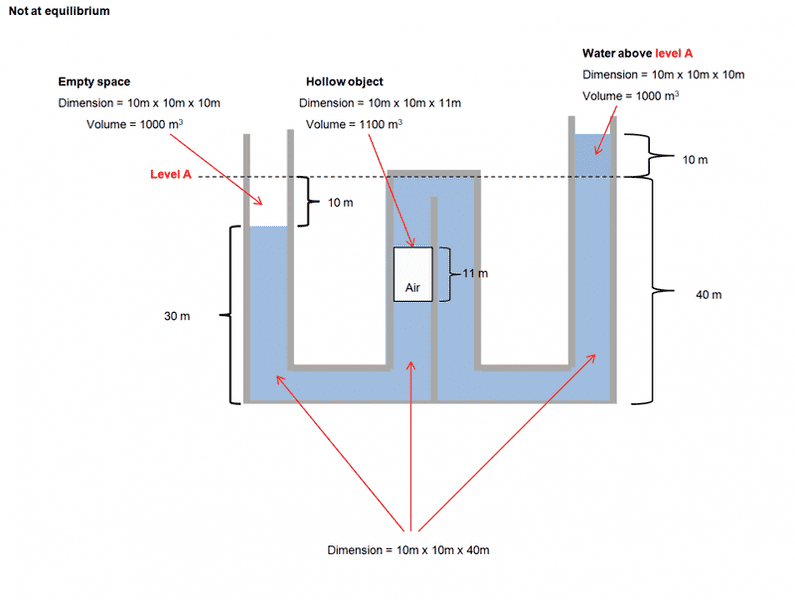

Thank you for the input. I am going to put up the diagram and put some numbers and see if my logic makes sense very shortly
So for the query I have asked I redrew the diagram and tried to put up some numbers to see if my logic makes sense.
For the solving of the problem I made some assumptions:
1. The blue liquid is water with a density of 1000 kg/ cubic meter
2. The gravity constant used will be 10m/ second squared (rounded for simplicity)
3. The hollow object in the middle column is rigid and does not compress and is full of air
4. The material making up the empty object is assumed mass less (for simplicity)
5. The hollow object can slide with zero friction up or down the water column and not allow water to pass between it's walls and the wall of the column
6. Each column has an area of 10m by 10m (looking down on the columns)
7. The heights of the water in the column is shown in diagram 1.
Thought process: (this is not exactly scientific but just how I did the logic in my head)
A. There is an imbalance in pressure in the columns and the far right column has greater pressure at the bottom than the other columns to the left
B. The middle left column where the hollow object is will only be able to have a constant height of water equal to 29 m.
C. The water in the far right column will move down because of the greater pressure (due to the extra 10 meters of height) -- the pressure transfers to the left columns undiminished until equilibrium is reached
D. the hollow object gets pushed down by the excess pressure coming from the far right column
E. Equilibrium is reached when 4.5m of height in the far right column gets transferred due to greater pressure -- to the far left column
F. The final height of water in each column is as follows:
Far left column -- 34.5 m (just below Level A)
Middle left column 29 m (same as before but hollow object is pushed lower)
Far right column -- 45.5 m (4.5 meters transferred to left columns)
My logic concludes that at these heights of water, the 5.5 meter of water above level A adds just enough pressure to the column with the hollow object to push the water up in the far left column to 34.5 meters in height. The hollow object is pushed down lower of course.
Pressure in far left column = height * gravity * density
= 34.5 *10 m/second square * 1000 Kg/cubic meter
= 345,000 Pa
Pressure in middle left column = height of water in column + (added pressure from far right column)
= (29 * 10 * 1000) + (5.5 *10 * 1000)
= 345,000 Pa
Thus, when 4.5 meters of water is transferred from the far right column (due to greater pressure) to the far left column, it will reach equilibrium.
I know I am sloppy with the explanation and the in showing the math...but is this more or less correct in terms of the final equilibrium?
The diagrams are below to kind of illustrate my question
Diagram 1 (non equilibrium)
Diagram 2 ( at equilibrium)
That result looks correct to me.
