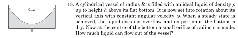

refer to the image
refer to the image

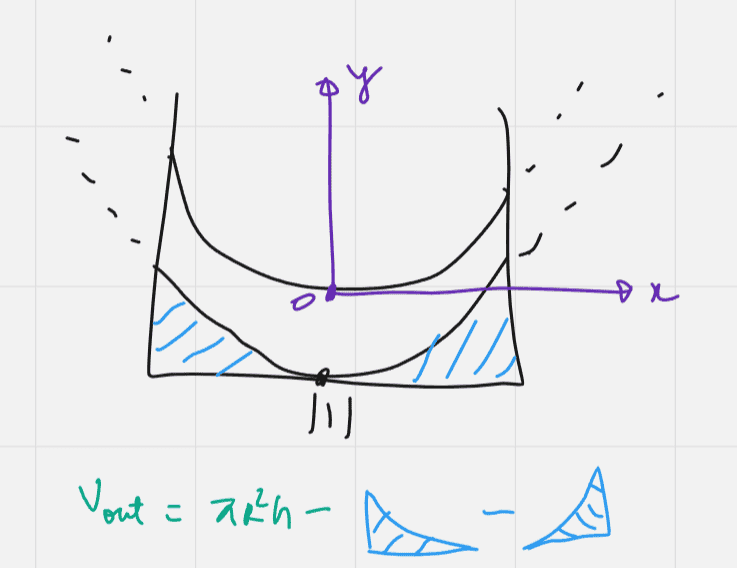

Let's say at the steady state the vertex of the parabola (paraboloid) is at the origin . Then the eqn of the formed parabola would be $$y=\frac{\omega^2x^2}{2g}$$ Now , initial volume of liquid is ##\pi R^2h## . As the liquid flows out of the orifice , the surface would maintain it's structure (paraboloid) till the vertex reaches the orfice . After that , liquid should stop flowing out .
Unable to think beyond this . I tried bernoulli but not sure how i would apply it as pressure is constantly varying with ##x##

I don't think your function fits the picture? The volume doesn't start out as a paraboloid, its initially a cylinder, the thing starts spinning and some of the water flies out leaving a parabolic cut out.
if you substitute ##x=0##, you get ##y=0##. Did they give you this function in the problem statement?

The equation doesn't fit the problem. At steady state no portion of the bottom is dry...
Its going to need to be something like ##y = kx^2 +C(\omega)##

We are finding the volume of the portion of fluid above the bottom of the paraboloid at steady state.
## x = 0, y = 0 ##? that is clearly not what is presented in the diagram. It ask how much fluid can drain out after a hole is drilled.
Note the similar shapes in the drawing. If we do the integration then we will get a useful volume as a result.
Ok, they put the origin at the vertex. They need to figure out the offset, I think I see now. Sorry.

##dV=2\pi x y dx=\frac{\pi\omega^2}{g}x^3\cdot dx## . So , my volume would be $$V=\int_{r}^{R}\frac{\pi\omega^2}{g}x^3\cdot dx=\frac{\pi\omega^2}{4g}\left(R^4-r^4\right)$$ So , final answer should be : $$V_{\text{out}}=\pi R^2 h - \frac{\pi\omega^2}{4g}\left(R^4-r^4\right)$$

##r## is the radius of orifice . Read the question carefully .

Why does the orifice suddenly opened effect the volume of the liquid in the container after the bucket rotating at constant angular velocity?
Maybe you should read the question carefully...

Because the liquid will drain out of the container until the orifice is no longer covered by the liquid.

But it says the liquid is filled up in the bucket to a height ##h## above the flat bottom. Then it spins at some ##\omega## and some amount spills out. Then the drain is opened. ##h## is the initial height of the unspinning volume. Don't they need to fine the volume left after it is spinning, before the plug is opened? "How much liquid can flow out"
The problem says "the liquid does not overflow".
No. It is the same as the initial volume, which is given by the volume of a cylinder with radius ##R## and height ##h##.
Volume flowing out = initial volume - final volume
This is not completely correct. It is a small effect, but you have assumed that the height of the surface above the bottom is ##\frac{\pi\omega^2r^2}{2g}## at ##x=r##. At that distance, the height above the bottom at ##x=r## when nothing flows out should be zero.
It should be 'approximately' true i guess as ##r## is given to be small . Hence , the second order term ##r^2\approx 0## . So , i guess we can only get an approximate answer .
The correct answer can be computed. There are a few ways to proceed. Let me try to suggest one.
You had computed the volume of the exterior of a paraboloid that sits a little bit too high. How much too high? If you slide the paraboloid down so that it rests on the rim of the hole rather than sitting on the imaginary point at the hole's center, how far down did you have to slide it? How much fluid is that?
Another approach is to concentrate on the volume of the shallow divot where the paraboloid sits below the rim of the hole. If you know how far the original paraboloid had to slide down to get there, that gives you a preliminary estimate for the volume of water that drains out. If you know the volume of the divot, that will tell you the error in that estimate.
Both of the above approaches should yield equivalent calculations and identical results. You're just changing up the inclusion/exclusion rule and changing the bounds of the integral. Either way you still have to figure out the depth of the divot.
