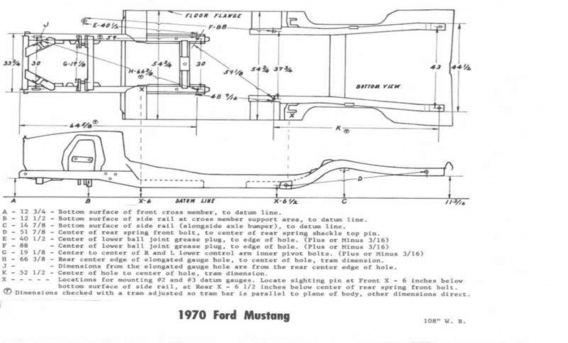

Is there a way I can post a graphic of the blueprint dimensions so as to better understand the best way to do this? Again, I appreciate the help!
Make sure the picture is compact and in a standard format such as .jpg or as a .pdf
Drag and drop it onto the edit window. It will be attached to that post.
This is similar to the blueprint to my 68. What would be the most accurate way for a guy at home to check these measurements? Before the measurements are taken, do I need to level the car? If so, do I just put jack stands on the rocker panels, then level the rocker panels. What do I use for the datum line?

Make sure you have a true flat surface ( floor). Once you have this raise car and measure rear spring perch bolt hole ( the front one) so it is 6 1/2 inch from the floor. Actually , you want to measure the "center point" of the bolt hole to the floor. Alternative is to measure the actual bolt hole ( it may be 1/2") find the radius and re-calculate. In this case , the correct distance from the floor to the " bottom edge" of the bolt hole would be 6 1/2" - 1/4" = 6 1/4" ).
Measure the other side to make sure both front bolt holes are same. Next adjust the front cross member "B" to be 12 1/2 inch. If the frame is straight you should have 6 " at the "X" location. You can check the remainder from there. Production cars are off as much as +/- 3/16" as noted in above print ..its sheet metal so do't get to worked up about it.

I think that is one of the problems. My floor is not flat. (I have a drain in my garage and the floor slopes toward that.)
