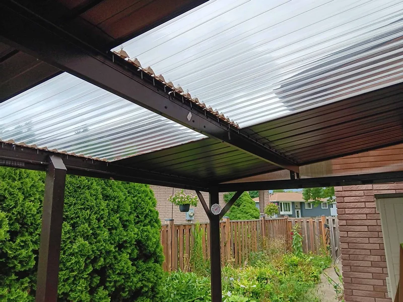

I'd hoped I could spray some sort of stopleak on the underside, but I suspect that won't actually stop the leak for long. The water will pool up and unseal the leak. So it probably has to be applied from the top?
Trouble is: it's 16 feet wide by 12 feet deep. The cross braces, where the leaks occur, are at 4 feet and 8 feet - well beyond my ability to reach them from the front edge with a ladder.

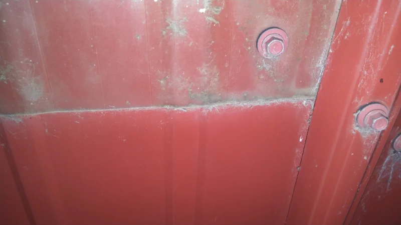

It's a lot like this, but huger:
I'd like to see a few pix. Does it leak on every screw?
Did the assembler use the kind of screws or nails that come with a little rubber grommet to seal to the rook when used?
Use an extra long-handled paint roller with black tar roofing goop. Male your own handle-extender if necessary. Make sure the tar and preferably also the weather are warm when you do it. And yes, of course it has to be applied from the top.
I will post pix ASAP. No.
It leaks under only a very few screws in the aluminum panels (~12').
Most of the leaks are under the lexan panels (so that's a 4' run at the 4' mark and another 4' run at the 8' mark)

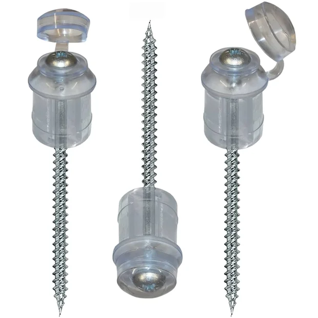

The primary reason for this is because the lexan panels use screw fasteners that are designed to go into wood, but the roof crossbeams are metal. This forced the dummy to pre-drill holes and then try to put the screws into the holes. Unfortunately, alignment is far from perfect and many screws went in at an angle, defeating the watertight seal.
Yes, but see above.

It's more than possible; it's trivial.
Don't even need a step ladder.

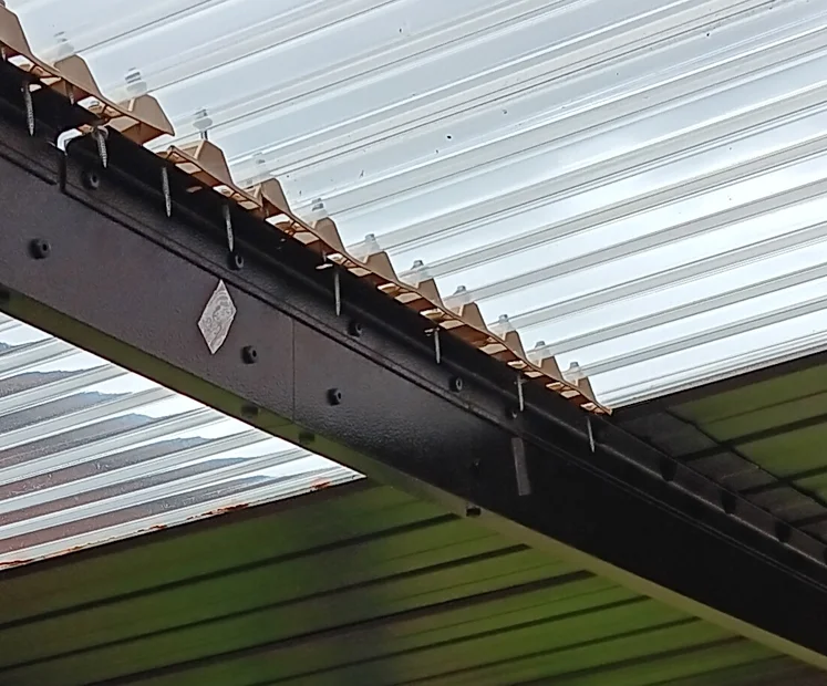

By the way, those two pieces of reflective tape dead centre show the worst leak.
And you can see how the wood screws with their rubber grommets, screwed askew, into the metal crossbar, do a terrible job of being watertight:

So is that some type of form underneath the clear sheets on top of the beam that goes across? Are they a substantial form? It's possible they are there to take the stress so the screw can be run in on top of the ridge. Seriously reduces leaks. Still an issue to get a screw made for wood to go through steel. And of course it's after the fact. Short self drilling screws made to go into steel are available with the rubber washer. The ones I've used were not very long and were made to install on the flat part of steel sheeting that looks similar to what you have off to the side of the clear plastic. Longer screws that self drill into steel are likely available.
Also, polycarbonate clear sheets are available that match (from what I can tell in your picture) the metal sheeting you show. I don't know how they perform laying flat with snow load and all.
Just that 16' long L-bracket.
I don't follow. Remember, this is custom.
The panels have wood screws, not compatible with going into a metal bracket. I had to pre-drill holes, and they were not well-aligned because the lexan panels are 12 feet long and there's a lot of torquing and flexing to be done.
Yes, self-tapping metal screws would have been better if I had done that from the start, but here we are.

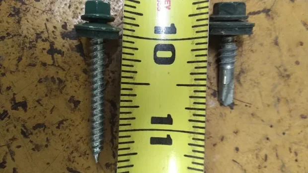

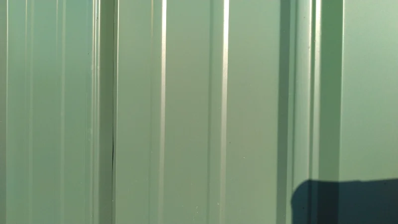

Wood screw vs metal. Both are made for ribbed sheeting.
Polycarbonate that matches the steel.
Better pic of the type of ribs I am used to
9 inch on center between ribs. Each sheet covers 36 inches. Care needs to be taken when installing to get the rain groove under the adjacent sheet instead of over. Can't see the rain groove after installation.

So, upshot: majority of leaks are coming from lexan screws, set in crests at janky angles, defeating rubber grommet seals.
