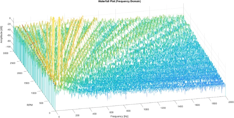

Hello everyone,
Im working on analizing the spectram domain of frequencies present on an PMSM when turning alone.
I attach an image of my Waterfall diagramm results, as you can see there are several frequencies that appear in parallel pairs with the same amplitude along the whole RPM range, my assumption is that these pairs represent a single frequency located in the middle but for some reason it is being represented as in the imaged be solved in the script?
or is there a problem in my PMSM that could make my frequencies look like this. search online for possible reasons why this happens
Code:

Im usinng matlab 2021[/s][/s][/s][/s]
For information the biggest 2 peaks are around 9.5 and 11.5 order, that links to the 2nd electrical frequencie of my motor with 10 poles
