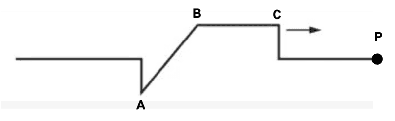

my answer was c because i thought that the particle would move in the same way the wave was coming...
Draw this picture on a strip of paper
Put it under a blank sheet of paper with the P on the right sticking out a little bit.
Now slowly pull the strip to the right
Get the idea?

Ha, the strip shows the pattern as in C. Yes.
But if you make a plot of the vertical position of the point where the line comes out from under the blank paper --as a function of the distance over which you pulled the strip, you get D
I grant you that the P is confusing. You want to consider it as a bead on the string that does not move with the string, but stays in position.
(i.e. on the right edge of the blank paper as you move the strip to the right).

but listen
think of it like waves on a water if this is a wave, P is a duck on the water, it will cause it to move up first...
and the wave will come out as moving upwards from under the paper too

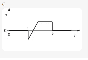

Looking at C:
What happens first, time "1" or time "2"?
Likes BvU
Hill said:
Looking at C:
time 2 happens first
Which way the time goes on this graph, to the right or to the left?
time is 0 at the left and increases on the right
Then, which happens earlier, "1" or "2"?
then 1 happens first because its time is earlier
Exactly. So, on the C the point would move down first, wouldn't it?
yeah, then?
the answer is D, how?

Then, the answer is not C, because as you correctly said about the point P,

Now that you got it, do you see why the required answer is the mirror image of the given waveform about point P?
its still a bit confusing, can you explain it to me?
is it because the part of wave which is in front is produced first, it gets to hit P first so it causes it to move up
Imagine that you are standing fixed at point P as the wave goes by you. You measure the following displacements from the baseline and times:
##y_A = -1~##cm at time ##t_A.##
##y_B = +2~##cm at time ##t_B.##
##y_C = +2~##cm at time ##t_C.##
Order the times from earliest to latest and mark them on a time axis.
Make a plot of ##y## vs time.
Connect the dots. What do you get?
The easiest way is to switch to the frame of reference of the pulse. So that stays still while P moves to the left. Clearly that flips the picture about a vertical axis.
The reason is that the picture is drawn with the pulse moving to the right, so going along the x axis from left to right is going backwards in time. Had the picture been the other way around the answer would have been obvious.
