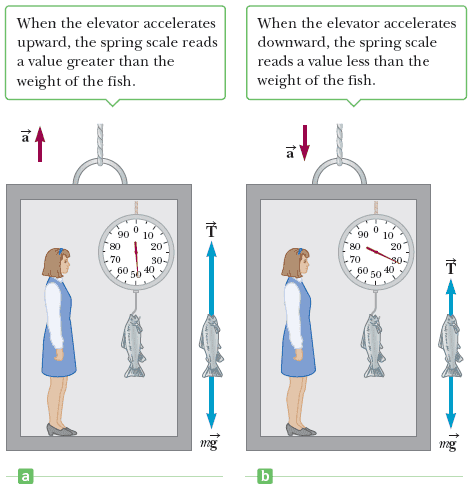

If the object is accelerating, the two forces need not match. For instance, if you jump up and down on your bathroom scale, the weight reading on the scale will fluctuate wildly while the force of gravity on your body remains constant.

Weight is only the vertical force (in the absence of any other vertical acceleration) that can be measured, for which that solid contact is necessary.
If linear acceleration, impact, or centripetal effect are also present, the measured contact force "(the force the object exerts on a surface/rope)" is usually greater than the weight and its direction may be different from vertical.
A bathroom balance would indicate temporary different values of body weight, in case of a person standing on it while inside an elevator that is being accelerated upwards or downwards.

The weight is not, in all cases, equal to the force the object exerts on a surface/rope.
It is only equal in inertial frame of reference when there object is perpendicular to the flat surface or directly attached to rope.
I am not from the USA / UK and here we have kinda different terminology. Weight is usually considered to be the pulling force exerted on rope / force that body exerts on surface (the one of which reaction pair is the normal force ##\vec{N}##). However we have the other thing that I wouldn’t be sure how to directly translate, probably something like Earth’s force of gravity? The force that Earth exerts on all objects in its atmosphere. That’s why I started this thread quite some time ago
