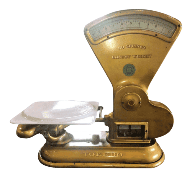

pervect said:
The point I'm trying to make is that the response of such a scale would depend on the velocity of the truck.
Yes, but it's an issue of what to do with that dependence.
The sort of weight one measures with a scale isn't the sort of weight we use in commerce.
Sure it is! Still the most precise way to legally weigh things is with a mechanical balance. Take a case where the legal weight really matters, the buying and selling of gold. They're not so silly as to buy and sell by a quantity that changes with location, they measure and use mass. Calling it weight, as is the legal practice.
The motto of the Toledo Scale Company: NO SPRINGS, HONEST WEIGHT. They're not measuring a force. They're measuring mass.
I'm not sure why the physics definition is what it is, but that is my understanding of the common usage of weight as it is used in physics and engineering, where we measure weight (and force) in Newtons. I'm not sure what papers you refer to that argue about issues about how to define the force. At the most basic level, I would treat the problem as a point particle
By far the two most common definitions of weight as a force each define a particle of mass ##m## as having a weight ##mg##. Where they differ is in how they define ##g##. I shall use the terminology "gravitational field strength" to refer to one, and "free fall acceleration" to refer to the other. In the literature and in the introductory textbooks the phrase "acceleration due to gravity" is used instead of one or the other of the above, inconsistently. While the terminology used to describe each of these two definitions differ, they are mentioned in virtually every introductory physics textbook.
I'm not aware of any issues with defining the force on a point particle, if you think you have some references that call this into question, I'd like to see them if you think the point is worth discussing.
I believe it is worth discussing. I think the pedagogical confusion is on par with the one surrounding the relativistic mass concept. Just as a pedagogical reform addressed that issue in recent decades, a similar reform is needed here.
The implications of this discrepancy in definitions is well-explored by these two letters to the editor, one by Mario Iona and the other Anthony P. French, each appearing in the Feb 1995 issue of AJP. (Am. J. Phys, Vol 63, pp.105 - 106). These were letters written in response to a previous letter that argued about objects in free fall, and whether or not they have weight. One of the two force definitions mentioned above assigns a nonzero weight to objects in free fall, the other assigns a weight of zero. The objects could be a common toy where a penny in free fall is caught in a tube, or an astronaut aboard the ISS.
Using the force definition where I refer to ##g## as the free fall acceleration, the value varies at sea level from about 9.78 m/s² at the equator to 9.83 m/s² at the poles. Two-thirds of that difference, 0.034 m/s², is due to Earth's spin, the remaining one-third or 0.017 m/s² is due to the fact that Earth is not a sphere and is wider at the equator. In this case the quantity ##mg## is called the weight, or as some textbook authors call it, the apparent weight.
In the other force definition, the one where I refer to ##g## as the gravitational field strength, its value only varies from about 9.81 m/s² at the equator to 9.83 m/s² at the poles. In this case the quantity ##mg## is the gravitational force, also called true weight (by those who use apparent weight in the way mentioned above). Among those authors who call it the true weight are those who use a value of 9.80 m/s² for ##g##. Befuddling!
For those considering this issue solved merely by a "clear" explanation of the distinction, witness the difficulty students have with the concept of weight. I've come to believe that if we want students to understand weight as a force (as opposed to being equivalent to mass) we must have coherent terminology that's consistent and clear, with one definition of weight as "a quantity of the same nature as a force" where ##g## is called the free fall acceleration. This distinguishes it from the gravitational force ##mg## where ##g## is the gravitational field strength.
