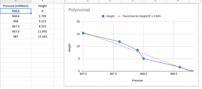

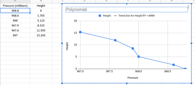

In summary: Google Sheets and not in Excel actually. I selected the option "aggregate" before, but now it's like this (image). The pressure unit in this data is millibar, and the height - is in meters. The trendline is polynomial with the second degree. The second image is exponential (Error).You need to put pressure on the y-axis (the vertical axis), and the height on the x-axis as mentioned by @DrClaude in post 3.The trendline is polynomial with the second degree

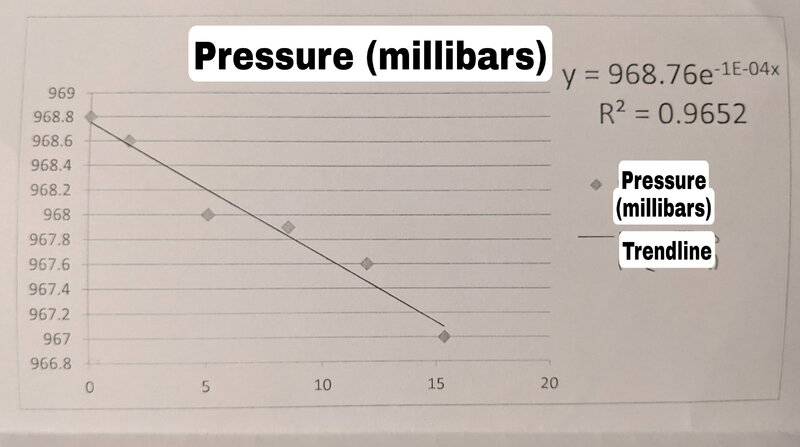

Hi,
as I know the barometric formula is an exponential equation, but when I did the experiment with a barometer at different heights and inserted these results in Excel for curve fitting, it showed a weird thing, I think. So exponential equation did show that R^2=0.942 and the second-degree polynomial R^2=0.997 (the third was even .999, but that's cheating because you can solve any equation with high degrees, but anyway...).
Is that because the max height was only 15 meters and the delta pressure millibars (and not thousands of meters)?
P.S. the experiment was conducted in the "perfect-ish" environment, in the building, with the same humidity, temperature, etc.

What about the result, i.e. the slope. Does it match the value you expect ? E.g if you try ##e^{-x}\approx 1-x## ?

Shouldn't you be plotting/fitting pressure as a function of height, no the other way around?

When you have the x-axis decreasing going left to right, and it should be the y-axis, it really is misleading. You can expect to find ## P(h)=P_o e^{-\alpha h} ##, (## h=## height above sea level), I believe even for the small changes in height that you have here.
Let ## h=h_o+h' ##, then ## P(h)=P(h_o+h')=P_o e^{-\alpha h_o} e^{-\alpha h'} ##, which is what you would call a new ## P_{experiment}(h')=P_o' e^{- \alpha h'} ##, but perhaps you already recognized that=You do get an exponential with ## h ' ## regardless of the altitude ##h_o ## that you start with to call your origin.

Even ignoring the other comments about your graphs, I believe you have drawn the graphs completely wrongly! For example consider the first three pressures:
P₁ = 968.8 mmHg
P₂ = 968.6 mmHg
P₃ = 968.0 mmHg
Pressure difference between P₁ and P₂ = -0.2mmHg
Pressure difference between P₂ and P₃ = -0.6mmHg
The 'gap' between the positions of P₂ and P₃ should be three times the gap between the positions of P₁ and P₂.
It appears that you have simply drawn ‘equally spaced’ the (unequally spaced) pressures on the x-axis.
Your table and graphs don’t specify units, which is bad practice. E.g. you could be measuring heights in feet – there’s no way to tell.
The pressure-changes are small so experimental uncertainties (both random and systematic) might be relatively large - large enough to make good fitting to a given equation impossible. If you include error bars, it will help you to see how well the measurements match a given equation.

Looks as if Excel ( ?:) ) considers these values to be labels instead of numbers

Yeah, I'm still here, just trying to understand things. So, I remade the graph in Google Sheets and not in Excel actually. I selected the option "aggregate" before, but now it's like this (image). The pressure unit in this data is millibar, and the height - is in meters. The trendline is polynomial with the second degree. The second image is exponential (Error).

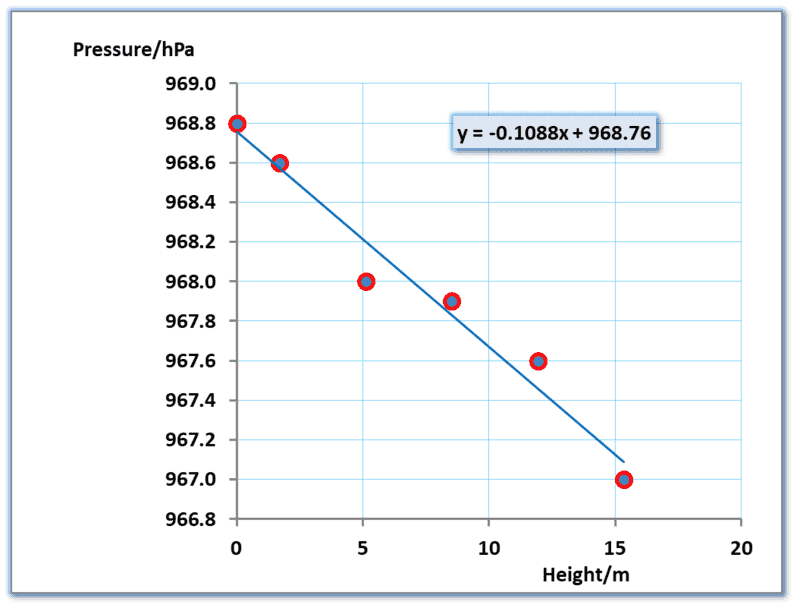

No reason at all for more than a straight line approach (post #2)
Leave out the blue lline: it has no role or purpose whatsoever.
And you vary ##h## and measure ##p##, so the axes should be swapped (post #3 and #8).
It is time you work out an expression for the slope of line ##p(h)## : the theoretical relation, for the case ##h## small (post #2).

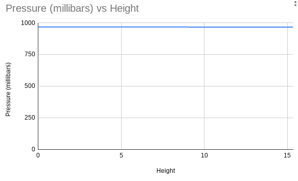

Just realized that pressure difference is so minimal at high numbers on the graph it seems like a horizontal line.

Note that theoretical ## P=P_o e^{-\alpha h} ## where ## \alpha=(MW)( g)/(RT) ##. Using a Taylor series for the exponential, ## P \approx P_o(1-\alpha h) ##, so that ## \Delta P/\Delta h=-P_o \alpha \approx -.12 ##.
(Note ## g=9.8 ## in MKS units, and ## T \approx 300 ## K).
From what I can gather, you are still on a learning curve with your mathematics, so I wrote it out for you here.
Suggestion though is to check my arithmetic.
The Taylor Series for ## e^x=1+x+\frac{x^2}{2}+...##. For small ## x ##, ## e^x = 1+x ## to a very good approximation.
One additional comment is it looks like you have a very good set of data.

so that ## \frac{dP}{dh}=-(1.29)(9.8)10^3/(1.0 \cdot 10^5) \approx -.12 ## mbar/m.
The vertical axis does not have to start at 0. With the right range you will see the change in pressure on the graph.

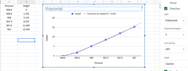

I did refitting the curve and found out that data has so few drops with fluctuations at the very small height it seems linear. Polynomial equations can solve anything but since the barometric formula is exponential, then it has also an exponential trend line. Everything looks fine now. I'll post a reply with the correct graph soon.

Don't forget to label your x-axis, include the units somewhere. Also check the coefficient in the exponent; I would increase the number of displayed digits there.
