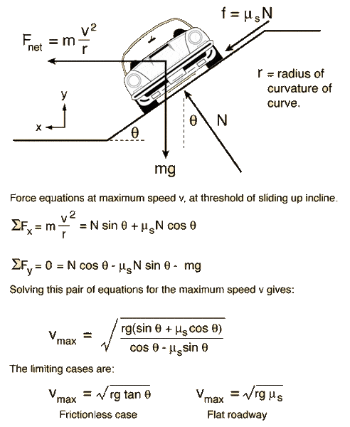

What will be the maximum velocity for a bike/car to go around in a well of death, when the wall of well of death is vertical, i.e. at 90 degrees ?
$$v_{max} = \sqrt{\frac{rg(sin\theta +\mu cos\theta)}{(cos\theta -\mu sin\theta)}}$$
While studying motion of car on banked curve, I was wondering, what will be the vmax when theta is equal to 90 degrees or is close to 90 degrees as it happens in a well of death which is organised in a village fair.
On a banked road with friction present, vmax is given by:
if we put theta = 90 degrees in the formula above, which is the angle in the well of death, then
But that is not acceptable, as vmax can't be an imaginary number.
I understand that if theta = 90 degrees, then the minimum value of v i.e vmin is given by:
This is understandable.
How do I calculate the value of vmax when theta = 90 degrees ?

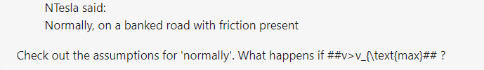

NTesla said:
Normally, on a banked road with friction present
Check out the assumptions for 'normally'. What happens if ##v>v_{\text{max}}## ?

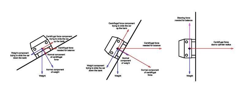

Maximum:
The maximum velocity in that case is limited only by the g-force pulling the rider or driver against the wall of the well.
Minimum:
At 90 degrees, the only lateral force on the vehicle is its own weight.
Like it happens to a car in a horizontal curve, the only way to compensate that lateral force is by steering the front wheels.
Because of the above, there is a minimum value of tangential velocity that is needed.
That forward velocity induces enough centrifugal effect to reach a minimum necessary value of normal force and lateral friction force to prevent the car from sliding down the well.

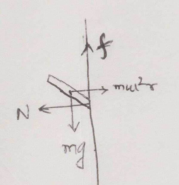

The answer to your question is simply to sketch a FBD of the situation. If angle is less than 90 degrees there will be a minimum speed and maximum speed in order to keep the car at a specific height. The normal force has a component in the vertical direction and is a counter to the weight component down the slope.
But in this case, the wall is vertical so the normal force no longer has a component in the vertical direction. The only force that can counter the weight is friction. So friction has to be pointed upward. Technically this means that there is no ##v_{max}## because any higher speed will not change the friction situation, nor will it change anything about the height. But if the speed is too low then friction cannot support the weight of the car.
-Dan

Hi @NTesla. Can l put my twopence worth in?
If you go round a banked curve at a sufficiently high speed, you tend to slide upwards. (You should understand why this happens.) Static friction opposes the upwards sliding by acting downwards.
If ##\theta \lt 90^o## and you are going too fast, you will may slide upwards because downwards friction isn't big enough to prevent the sliding. Your maximum speed to avoid sliding upwards is ##V_{max}##.
Note that if ##\theta= 90^o## there is no tendency to slide upwards (and you should understand why).
The equation for ##V_{max}## applies only when the frictional force is at its maximum (limiting) value of ##\mu N## and is acting downwards - because that’s how the ##V_{max}## equation is derived. But when ##\theta = 90^0## there is no downwards friction because there is no tendency to move upwards. Friction will act upwards and it's magntiude will equal ##|mg|##; the equation for ##V_{max}## is inapplicable.

Additional note. It’s not just ##\theta = 90^o## where care is needed. For example if ##\mu = 0.9## and ##\theta = 60^o## then ##\cos(\theta) - \mu \sin(\theta) = \cos(60^o) – 0.9\sin(60^o) = -0.279## which gives a negative value inside the square root.
That’s because the ##V_{max}## equation cannot be used because friction doesn’t need to reach its limiting value to prevent upwards sliding for these values of ##\mu## and ##\theta##.
The ##V_{max}## equation is therefore inapplicable in this case- and this was signalled by the fact that ##\cos(\theta) - \mu \sin(\theta)## was negative.
Likes NTesla, MatinSAR, topsquark and 1 other person
  • #32
When you write an equation to represent a physical behaviour, it often only applies in a range of situations. In this case, in writing the equation, you have assumed that there will be a speed at which it will slide up. If you get a silly answer, likely the assumption was false.
Even before you substituted θ=90° there was a problem. You can see that for any θ>0 there are values of μ which give an infinite or imaginary result, telling you it cannot slide up. What θ=90° did was to push all values of μ into that class.
Likes MatinSAR, topsquark and Lnewqban

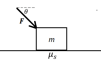

  • #33
This reminds me of the problem of trying to slide a box across a rough horizontal surface with a force applied at a downward angle:
For a given ##\mu_s##, if ##\theta > \tan^{-1}(1/\mu_s)##, then the box will not slide no matter how strong the force ##F##.
Likewise, for this problem. If ##\theta > \tan^{-1}(1/\mu_s)##, then the car will not slide upward on the slope no matter how fast the car is traveling. There is no ##v_{max}## for ##\theta > \tan^{-1}(1/\mu_s)##.
Likes Steve4Physics, MatinSAR, topsquark and 1 other person

  • #35
In the vertical wall case (horizontal rider), what force is balancing the torques about the point of contact?
P.s. This is me asking, because I’m not seeing it; not me asking the OP.
Likes NTesla and topsquark
  • #36
The rider has to incline at an angle to the horizontal as shown in this diagram:
https://www.scienceabc.com/wp-conte...oads/2015/10/force-acting-on-a-bike2.gif-.gif
(which is from this site: https://www.scienceabc.com/pure-sciences/science-behind-the-wall-of-death.html)
In the rider’s (non-inertial, rotating) frame of reference, the (fictitious) centrifugal force, acts through he centre of mass, providing the necessary torque to balance the torque from the weight.
In the ground (inertial) frame of reference, it’s harder to explain - so I’ll leave it to someone else!

  • #39
Has anyone considered the torque due to the car center of mass not being right at the wall and how that impacts the problem?
  • #40
For the bike case, the bike is angled so that the net reaction from the wall passes through the mass centre. For the car, the same can be done except that it is limited by the angle the mass centre subtends to the wheelbase each side. If a vertical through the mass centre falls below the wheelbase there is a minimum speed to avoid rolling, and if a horizontal through it passes above the wheelbase there is a maximum.
  • #41
I would like to understand this further...
The bike is definitely angled, as I've seen in the videos and pics available on internet. But, I'm still trying to figure out how to understand it. When an object is on an incline, the reaction force from the surface is Normal to the surface. However, presently we are discussing about the situation when the wall is perpendicular to the ground. In post#40, you've mentioned that net reaction from the wall passes through the mass center. Could you kindly clarify what constitues the net reaction from the wall. I am assuming that one is the Normal reaction from the wall(which is normal to the surface of the wall), another is friction (acting upwards). Would the vector sum of these forces is the net reaction from the wall that you had mentioned in post #40 above.
  • #42
The bike is definitely angled, as I've seen in the videos and pics available on internet. But, I'm still trying to figure out how to understand it. When an object is on an incline, the reaction force from the surface is Normal to the surface. However, presently we are discussing about the situation when the wall is perpendicular to the ground. In post#40, you've mentioned that net reaction from the wall passes through the mass center. Could you kindly clarify what constitues the net reaction from the wall. I am assuming that one is the Normal reaction from the wall(which is normal to the surface of the wall), another is friction (acting upwards). Would the vector sum of these forces is the net reaction from the wall that you had mentioned in post #40 above.View attachment 318564
I have to be careful with the wording here. A force is more than just a vector; it also has line of action, which vectors in general do not have. Likewise, the net force of a collection of forces is more than just their vector sum. Its line of action is such that it has the same net moment about any given axis.
So I would rather say the net of normal and frictional forces passes through the mass centre. Were it not to, there would be a net moment about the mass centre.
