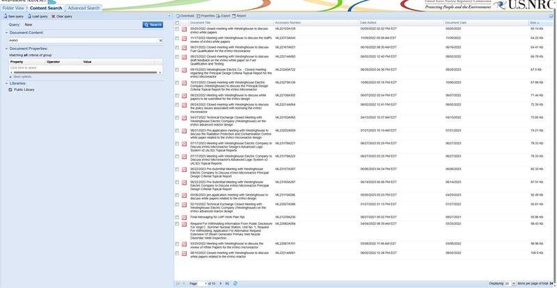

Searching ADAMS for evinci in the document name finds hits but they all look like meeting notices. I'm thinking the technical stuff is proprietary. Not sure where to find something in the middle, between advertising and Topical Reports. There should be non-prop Topicals.
