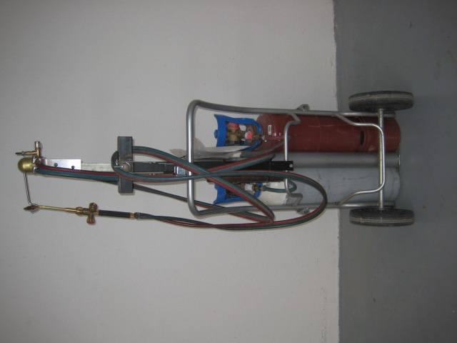

This has been bugging me for a few months now, and I'm hoping that someone can provide me with an answer.
A while ago, my colleague was soldering with an oxy-acetylene torch and paused for a few moments in between jobs, leaving only the pilot light on top of the unit burning. Sitting about 4-5 metres away, I happened to use my air pistol to clean a mechanical component, when he noticed that the pilot light had suddenly increased in length. He shouted and called my attention to it, which led to us speculating as to what might be causing it. The flame wasn't affected laterally - increasing only in length, so we ruled out air disturbance or pressure from sound waves. I also tried banging the bottles, humming at various pitches, shouting and clapping - all to no avail,
Eventually I walked across the hall and tried with another air gun about 20 metres away and the result was the same as the original. Noticing that the flame on the pilot light turned from blue to a sooty yellow colour during the moments when the air gun was activated (indicating incomplete combustion), I reasoned that the sound of the escaping air was at a frequency which resonated with the acetylene, causing a disturbance in the mixture of the two gasses.
I could be completely (even laughably) wrong, but it'd be great if I could get an answer as to what was causing it and finally set my mind at rest.

Sorry, I meant tap the cylinder valve, not regulator. I can't find any pictures of these. The best way I can describe these cylinder valves is that they have curved levers for handles, which you pull up towards you to open the flow and push down away from you to shut off the flow. The actual regulators themselves are typical regulators with two pressure gauges. I'm not that familiar with the set-up (or oxy-acetylene in general) and only use it occasionally, but from memory there are two (for want of a better term) lever cylinder valves, which open the flow from the bottles, two needle valves on the torch and a needle valve for the pilot light.
With regard to soldering, I actually meant braising (in this case braising with silver). My English isn't what it used to be after many years living abroad and I translated directly from the Danish lodde, which means solder. So yes, it's braising with oxy-acetylene, though with a gentle flame. My apologies for the confusion.

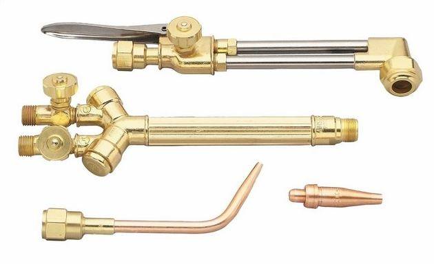

Over the years I've used Victor, Miller, and Linde gear. No preference, really - it boiled down to whatever manufacturer the local gas & welding supply dealer carried at the time, but the downside is that while hose connections are standard, none of their torch parts are interchangeable. Pictured below is a small Victor torch kit.
The main body has two needle valves at the gas connections prior to a mixing chamber. Welding tips (at the bottom of the image) are available in a range of bore sizes to accommodate different task requirements, and one would be mounted onto the torch body for welding, or brazing service.
For cutting, the bullet-shaped tip at the lower right (again, available in a range of sizes) is fitted into the cutting head shown at the top. Preheating is done by feeding an oxy-acetylene mix determined by regulator settings in conjunction with torch body needle valve setup (most often adjusted to provide a neutral flame) through the lower tube, along the tip periphery and through a rosette of tiny holes around the tip face. Once the piece is hot enough, the cutting lever is depressed to send a gout of O2 (adjusted by the needle valve adjacent to the lever) through the upper tube, and into a large hole bored into the tip's center.

Hi Asymptotic,
Yes, I'll try and take a camera with me at some point and incorporate your suggestion with the cardboard box. I just have to make sure I do it after my colleagues and supervisor have gone home, as it's forbidden to take photos where I work. Not that I haven't done it before in connection with work-related matters, but I'd have a hard time explaining this one to my boss, were I discovered. In the meantime, the pilot is situated on top of a separate feed that runs to a tubular metal structure on top of the rig which also contains (for want of a better description) a hook-type lever, which cuts off the flow to the torch when it's not being used - the torch being hung by its tip on the hook. The needle valve for the pilot light sits on the same structure - i.e. not on the torch.

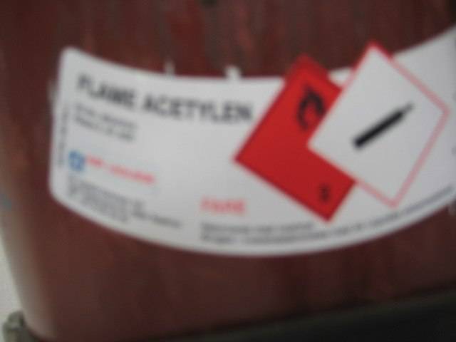

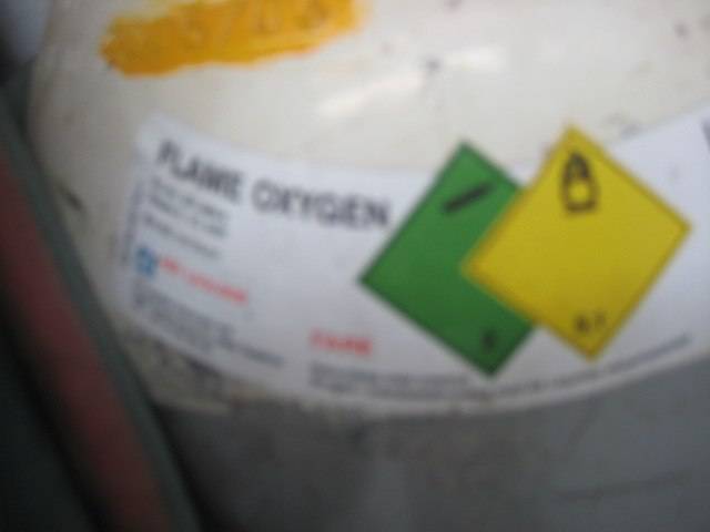

I can't remember the colours of the bottles off hand. I'm not a regular user and it's been a few months since I last used them. Also, I could be wrong on the regulators, so don't quote me on those - especially as there are two different oxy-acetylene rigs. No, there is no compressed air line to the rig. In addition, given that we have yearly ISO inspections, I imagine they fall under ISO standards.

As I mentioned to Asymptotic, I'll try and get some photos done soon to clear up any confusion.

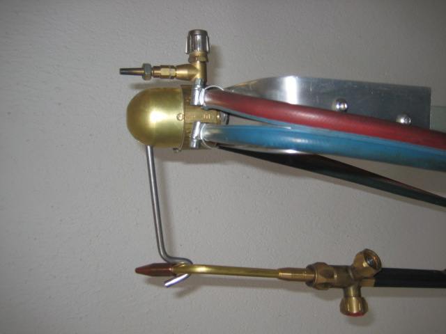

fleetingmoment said:
... the pilot is situated on top of a separate feed that runs to a tubular metal structure on top of the rig which also contains (for want of a better description) a hook-type lever, which cuts off the flow to the torch when it's not being used - the torch being hung by its tip on the hook. The needle valve for the pilot light sits on the same structure - i.e. not on the torch.

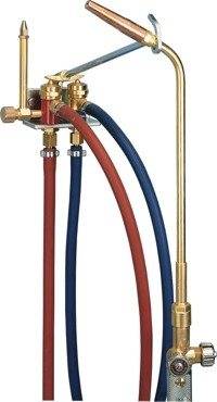

Does it looks something like this?
Yes, that's pretty close to it.
The gizmo is called an 'economizer' - this one is from a German company (Zinser). The hook toggles against a pair of normally open valves, and closes them when the torch is put into place. Fuel gas for the pilot is tapped off prior to the shut-off valve, and mixed with ambient air.
Don't know how much closer this gets us, but at least variation in the the oxygen circuit is out of the picture.

This is a different color-coding scheme than any I'm familiar with, but the gray tank with white neck suggests oxygen.

Two observations about economizer mounting - the distance between the last support point and the economizer is very nearly the height of the cart itself, the aluminum right angle bracket it is bolted to appears rather "springy", and has a fairly large angle away from horizontal. For the first and second point, I'd bet it becomes resonant at a number of audible and ultrasonic frequencies. For the third point, the flame front won't sit evenly around the annulus of the burner tube, and I suppose this would increase the sensitivity of the flame to disruptions.
