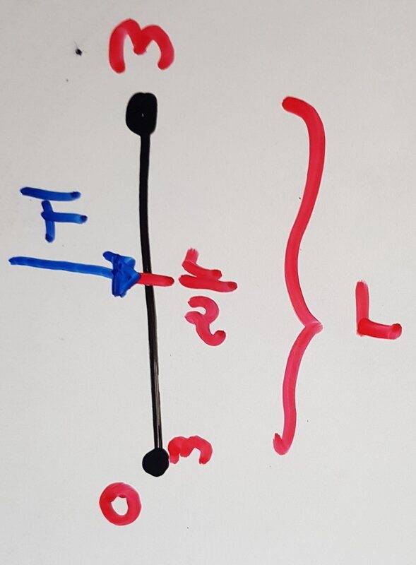

I've been taught that any force not going through the centre of mass will create torque.
Consider a rod of length ##L## and negligible mass, with two balls of mass ##m## attached to its ends. Its centre of mass is at ##\frac{L}{2}##.
I have two questions:
1) If a force ##F## is applied to the centre of mass and we consider the centre of mass as the origin, the torque will be zero. But what if consider the point ##O## as origin. Now, that force will create a torque ##\tau =-F \frac{L}{2}## and so it will rotate because of the angular acceleration. But we're considering the same force at the same point. Shouldn't we get that the rod will not rotate?
2) is there any point of the rod that, if applied a force to it, will cause the rod to rotate but not to translate?

1) Torque and angular momentum are relative to a point (or axis). You must always say the torque/angular momentum about some point. The torque about the centre of mass is zero, but the the torque about the origin is not. So, you have no angular momentum/rotation about the centre of mass, but you do have angular momentum about the origin.
Note: a particle moving in a straight line has zero angular momentum about any point on that line, but non-zero angular momentum about any other point. And, if the motion is at constant speed, then the angular momentum is conserved.
2) No. Newton's second law applies. In this case, for an extended rigid body, ##\vec F = m \vec a_{CoM}##.

Not so fast.
If you consider the point ##O## as the origin then a force (not in line with ##O##) will create a torque, yes. And that torque will result in a rate of change of angular momentum, yes.
But that angular momentum need not manifest as a rotation. Linear motion of the center of mass relative to a chosen axis not on the line of motion of the center counts toward angular momentum about the chosen axis.
##\sum F=ma##. If you apply a non-zero net force, you will get a non-zero translation.
However, if you extend the rod out past both masses then the farther out you apply the force, the greater the ratio of torque to force. If you apply the force far enough out, a negligible force will result in the desired rotation.
You can also apply a "couple". A pair of equal and opposite external forces that do not share the same line of action. Then you get a net external torque without a net external force.

The object will gain angular momentum unless the sum of the external forces act through the center of mass.
In your example where the origin is moved, the object will not rotate about the center of mass but the system will have angular momentum about the new origin. Torque and angular momentum depend upon choice of origin. Their relationship does not.
