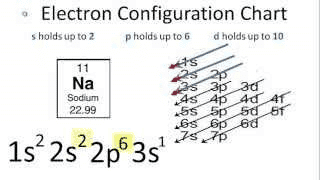

The shown below is an electron configuration for sodium. In the compound sodium chloride the valence electron of sodium has been taken away by chlorine. In other words, sodium is left with its full 2p orbital. Is it electron(s) of 2p orbital which makes energetic transition to 3s orbital and then fall back to original 2p orbital and emit visible light photon?
Source: https://terpconnect.umd.edu/~wbreslyn/chemistry/electron-configurations/configurationSodium.html

I don't see how sodium has a valence electron in its 3s1 level in case of sodium chloride. Please see below and please guide me.
Once it gets airborne everything can happen, some ions become just atoms, grabbing electrons from other ions. Not many of these (most sodium is still in form of ions), but the transition is very common and easy to observe.

Thank you but I'm sorry that I don't follow you. If sodium chloride is in powder form, both sodium and chlorine ions act as a one single unit joined together very strongly. I don't see how and where sodium ion would grab an electron to become an atom. On the other hand, sodium atom would react with oxygen in air.
Not exactly. They are separate ions, just ordered in the crystal. There is no "single unit". On evaporation (or dissolution) each one goes on its own. Sure, they do attract each other, but they are not a single unit.
In the flame there are plenty of charged things that will both grab and donate electrons.
Yes, once it gets into a cool part of the flame it will stabilize itself in some compound. Not so easily and not so quick in the flame itself, and the amount of sodium atoms created (not all ions will become atoms, only a fraction) and their half time are enough to produce visible sodium light.
