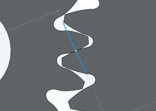

What do you call this long angled gear piece?

They are pinions;
or planet gears, orbiting a sun gear.
They are not so much long, as they are wide, the width is measured along one tooth.
That doesn't get me results on Google images of similar gears. I'm talking about the individual gear pieces.
Baluncore said:
They are pinions;

Helical pinion.
The typical helical pinion isn't long enough. Isn't there a specific name for such long helical gears?
Art. Based on a hyperbolic (or: hyperboloidal) planetary gearset.
You are also free to call it as 'nightmare of mechanical engineers', if you wish.
You are also free to call it as 'nightmare of mechanical engineers), if you wish.
Hyperbolic gears are narrowed in the middle.

Fair point, but this was the best image I could find for what I'm actually looking for- a long cylindrical gear with angled teeth.

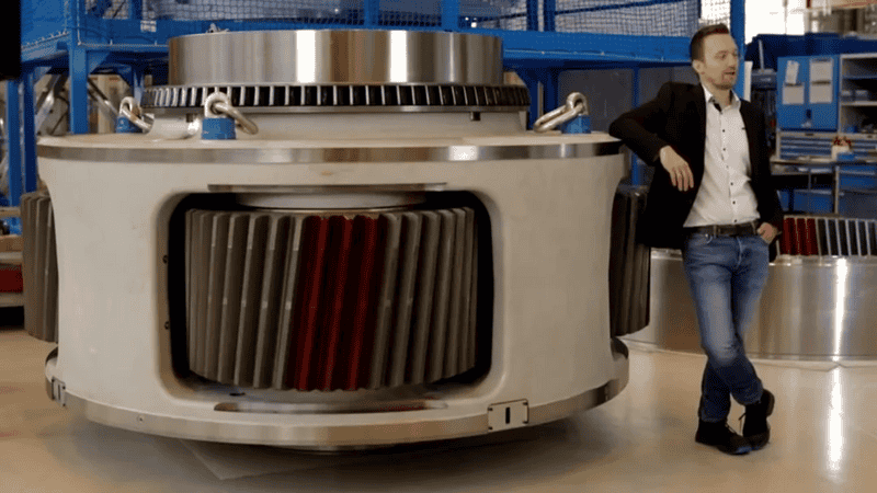

Application: turboprop. Efficient gas turbine engines, rotate too fast to drive an efficient propeller, without a reduction gear.
A hyperbolic pinion gear looks difficult, but it is generated simply from straight lines of contact between gear pairs.

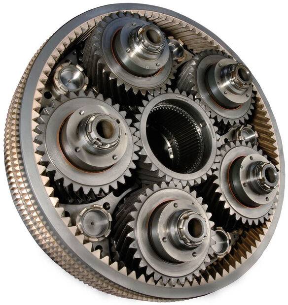

A gear is made wider, when it needs to be strong and reliable. Notice that the teeth on the gear are helical-cut, so they overlap by only one. That will be quieter, because only the lubricated point of contact or separation will generate noise, while the line of contact spreads the contact force, lowering the pressure.
Planetary gears are balanced and enclose the reaction forces between the gear shafts. Many teeth are acting at one time to transfer the forces.

This looks like a graphic. Does anyone have a photo of a 'real one"?
The issue is, that the image is made as an art/simulation. Where this kind of setup is chosen the torque (or speed, or size) usually does not allow those long, thin gears (subject to bending and related wear) with enhanced visual impact.

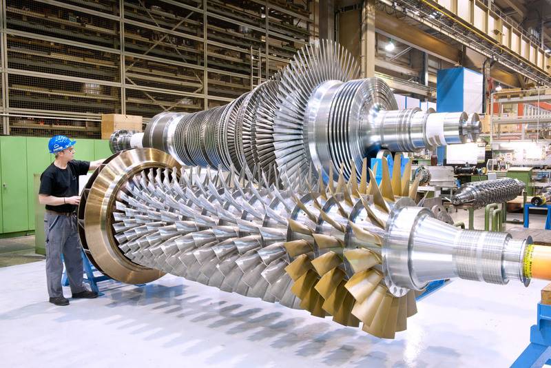

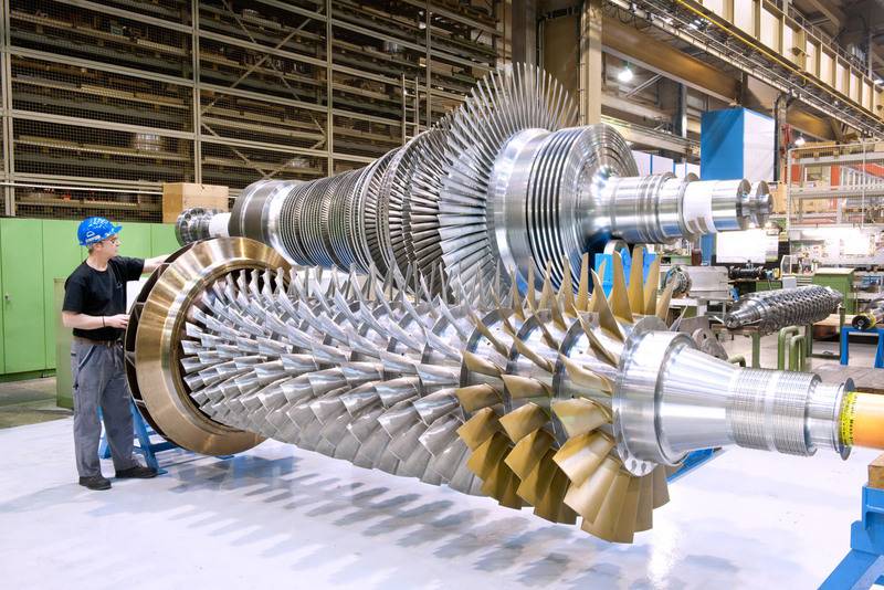

I think that line of thinking is more aligned with axial compressors than gears.
You may find better matches on that line.
Apparently, 'gearing up' given you a very misaligned start here.
If it's a long single stage (more gear-like) then you'll have to think a lot on the change of pressure.
Also, there is a reason why it's not a continuous gear 'teeth'.
