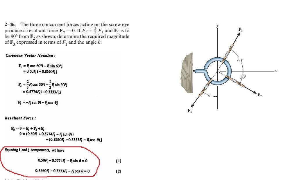

Hello! :)
I just want to ask how, did the encircled portion come about?
It says that it equates the $\hat{i}$ and $\hat{j}$ components.
but when I tried that, this is what I get
$0.5447F_{1}=F_{3}(\sin(\theta)-\cos(\theta))$ ---> This expression doesn't ring a bell. It doesn't make any sense to me.

Hi Drain Brain,
The $\mathbf F_R$ on the left hand side is really:
$$\mathbf F_R = 0\cdot \boldsymbol{\hat\imath} + 0 \cdot \boldsymbol{\hat\jmath}$$
Since the $\boldsymbol{\hat\imath}$ component is completely independent from the $\boldsymbol{\hat\jmath}$, we match them left and right.
Put otherwise, we separate the equation in:
- Sum of the horizontal forces is zero
- Sum of the vertical forces is zero

Hi, I Like Serena!
Can you tell me why the i and j components become 0?
What I'm thinking about the problem is that the components of $F_{R}$ are equal in magnitude but opposite in direction that's why they cancel each other and produce a resultant of 0. Is my line of thinking correct? If not please explain to me why the components became both 0. Thanks!
Drain Brain said:
Hi, I Like Serena!
It's because the problem statement says:
The three concurrent forces acting on the screw eye produce a resultant force of $\mathbf F_R = \mathbf 0$.
