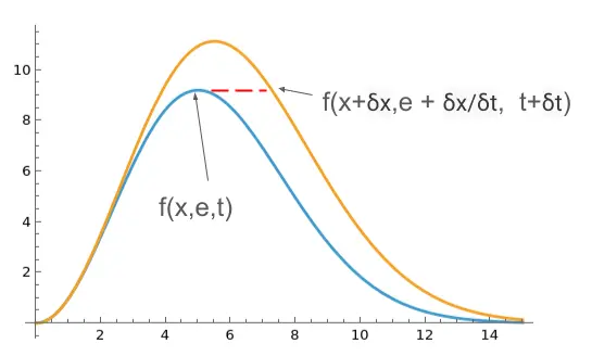

Thank you for the detailed answer. I will be reading it and trying to pick up the prerequisites from the links you provide. Meanwhile, referring to the equality in my original post, is this what that is saying?
Edit: No, that's probably not correct. I would expect the two curves to be the same if the temperature is constant over the fluid and if the macroscopic velocities are the same in the region we are looking at. So in terms of this graph, what would the visual/graphical/intuitive explanation look like?
@Swamp Thing In the plot you show, what is on the horizontal axis and what is on the vertical axis? How did you obtain these blue and orange curves?
Sorry for not labeling the axes. The plots show f(x,e,t) as a function of e for some fixed x, t. They are not to scale but just represent the general shape of the Maxwell-Boltzmann distribution.
In Mathematica:
Code:
Plot[Evaluate[Table[(x)^2 Exp[-((x)/a)^2], {a, {5, 5.5}}]], {x, 0, 15},
  PlotRange -> All]
It's based on this from the Wikipedia article on the Maxwell-Boltzmann Distribution:
The tutorial I referred to in my original post shows similar-looking plots and says they are based on this distribution.

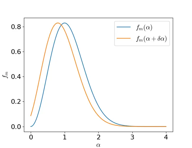

@Swamp Thing In this case the statistical distribution function ##f_m(v)## depends solely on the speed ##v## (I added the subscript "##m##" in ##f_m##, which stands for "Maxwellian", to distinguish it from your "full" ##f(x,e,t)##). This means that the probability ##\mathrm{d}w## to find the speed of a random particle between ##v## and ##v+\mathrm{d}v## is given by ##\mathrm{d}w = f_m(v)\mathrm{d}v##. Now, if you introduce the most probable speed ##\tilde{v} = \sqrt{2k_{\rm{B}}T / m}## and use it to define the dimensionless ratio ##\alpha \equiv v/\tilde{v}##, then said probability can be rewritten as ##\mathrm{d}w = f_m(\alpha)\mathrm{d}\alpha##, where
f_m(\alpha) = \frac{4}{\sqrt{\pi}} \alpha^2 e^{-\alpha^2} \rm{.}
This is just the Wikipedia formula you quoted, but rewritten using a dimensionless variable ##\alpha##, which may be more convenient, e.g., for plotting and using it in computer simulations (in contrast, note that in your Mathematica prompt you additionally defined the parameter "##a##").
Now, changing the speed by some ##\delta v = \delta x / \delta t## is the same as changing the dimensionless ratio ##\alpha## by some ##\delta \alpha##. If you now set up the horizontal grid for ##\alpha##'s and then use it to plot the Maxwellian functions: ##f_m(\alpha)## and ##f_m(\alpha + \delta\alpha##), then you will find that the "height-of-the-peak" of both distributions is the same and only their positions are shifted (by the amount ##\delta\alpha##).
Here is the appropriate plot I made in Python (here, ##\delta\alpha = 0.2##):
Does this clarify some of your issues?
