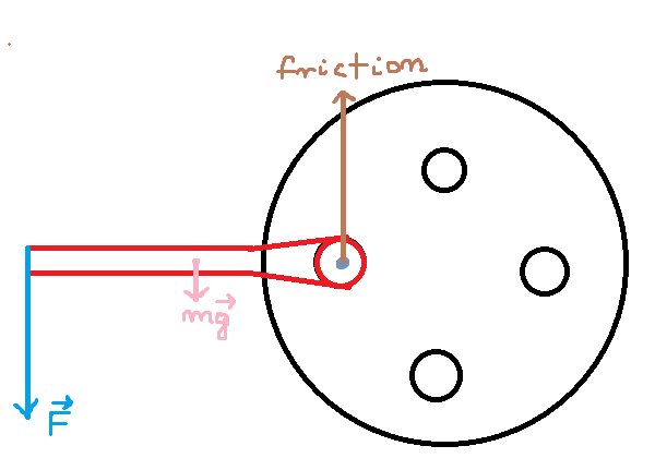

Let's say we want to change a wheel in a car. We want to remove bolts fastening the wheel using this tool:
I have also drawn a diagram of the forces in operation:
Now, from experience, I can say that the point of rotation of the wrench will be the blue point. Now, trying to determine the torque relative to that point leaves us with a net torque anticlockwise (friction gets canceled out).
Yet, we know that removing these bolts requires some effort. Therefore, there either are more forces in action or the axis of rotation I chose is incorrect (or both)
What am I missing?
If this is a 'real world' problem and not a sterile academic assignment then you are probably missing the fact that corrosion has actually fused the nut to the bolt; and, until you can apply enough force to actually shear the metallic bond then no other forces are going to come into play.

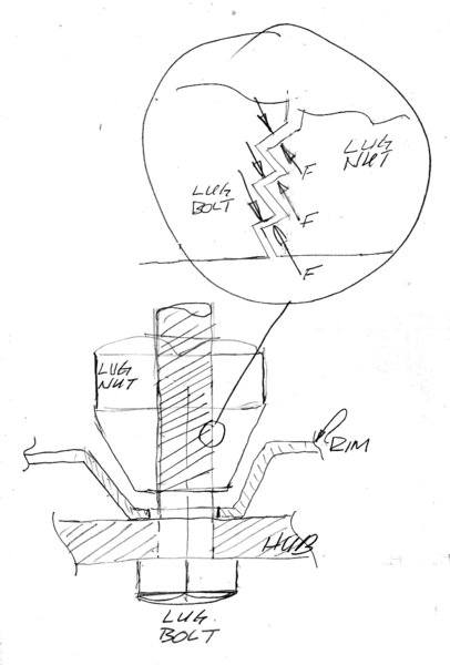

Point of clarification:
As shown in the above image, when the lug nut is tightened there is a frictional interface between the lug nut and the lug bolt threads. The tighter the nut the greater the friction between the two.
The lug nut should be tightened just enough to take full advantage of this frictional force without over-stressing the lug bolt’s tensile properties. This is achieved by applying the proper tightening torque using the proper wrench for the job as per the car’s specifications.Also note the bevel on the end of the lug nut. It is designed to fit into a corresponding taper in the wheel rim. This causes the wheel to be centered on the lug bolts and removes any sloppiness (play) between the wheel rim and the hub. There must be some sloppiness to allow the wheel to be fitted over the multiple lug bolts. However, this sloppiness can not be allowed in the working interface between the wheel rim and hub because, under the right conditions, any slight movement between the two will ,over time, loosen the lug nut. Note: Most cars have right hand threaded lug bolts fitted to one side of the vehicle and left hand threaded lugs fitted to the other side to help prevent loosening of the lug nuts. As long as the lug nut is clamping the rim to the hub (it is tight), there is also friction at the rim-lug nut-hub interface (On the tapered portion and at the very end of the lug nut).
So, to remove the lug nut, one must therefore overcome the frictional forces on the threads and between the lug nut-rim tapered interface using a moment or torque. (Foot-pounds).
With corrosion these forces can be immense.
