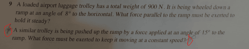

See attached.
Mechanics
My question is on the highlighted part in red.
For the first part i have,
##F_{parallel} = 900 \cos 82^0 = 125.3N##
For the second part, i have
##F= \dfrac{125.3}{\cos 15^0} = 129.7 N ≈130N##
Likes Lnewqban
##F= \dfrac{125.3}{\cos 15^0} = 129.7^0 N ≈130N##
Those answers look right to me. (I guess there is no friction). However, based on what you've written, we can't tell if you thought through it correctly.
