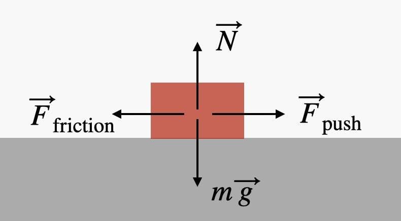

Clockclocle said:
Because It make nonsense if friction remain still, it has to be reduced to make sure the object don't move backward.
When you release the pushing force on a moving object, then the friction force is equal to ##ma##. This means the object will decelerate, thus the velocity will get smaller. Once the velocity reaches zero, the object no longer moves, the kinetic friction doesn't exist anymore (by definition), the acceleration drops to zero, and the object velocity stays constant (at zero).
If the object is on an inclined plane (going against gravity), then gravity will play a role that will affect the acceleration, and when the object will stop (velocity = 0), the kinetic friction will be replaced by static friction. If static friction is not strong enough to hold the object still, then the motion will reverse, with static friction replaced by kinetic friction.
Likes PeroK, davenn and Lnewqban
