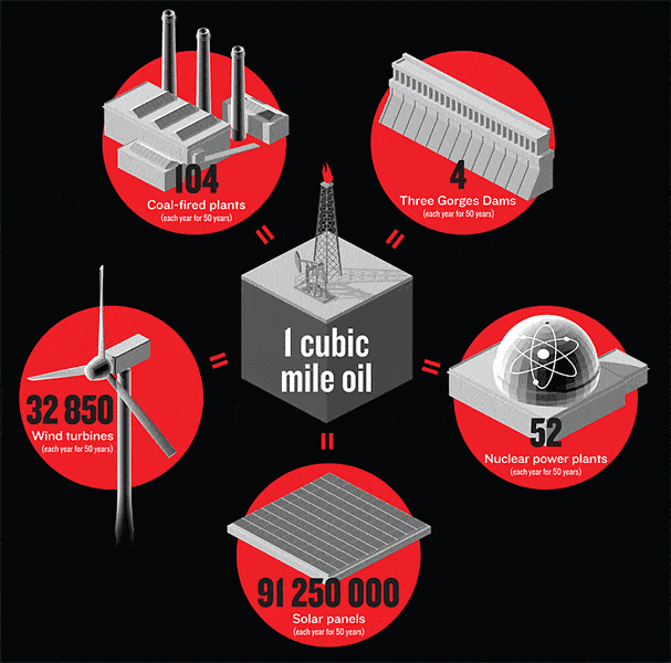

The world uses around a cubic mile of oil per year.
http://www.theoildrum.com/node/3084
From http://spectrum.ieee.org/energy/fossil-fuels/joules-btus-quadslets-call-the-whole-thing-off
Prepare for your mind to be wonderfully sobered. To obtain in one year the amount of energy contained in one cubic mile of oil, each year for 50 years we would need to have produced the numbers of dams, nuclear power plants, coal plants, windmills, or solar panels shown here.
,, "here" referring to this graphic from 'theoildrum'
So start today building a hundred windmills every day.
At end of fifty years, if they last that long, you'd have built enough (about 1.6 million) that you could shut off the oil spigot. Well for today's usage anyway (actually 2006's).
But the first half million you built will be getting might rickety by then...
And that's a technology problem not a political one.

Hi Jim!
Very interesting picture!
Thank you for supplying it.
It really sobered me up ;)
With regard to the picture, I once calculated that it goes around 10000 wind mills in a nuclear plant.
Your nice picture shows some 660 "only".
I think it is even worse.
Anyway, some 50 nuclear plants as substitute for the huge qubic mile of oil consumed each year is astonishing to say the least.
50 nuclear power plants built per year.
1 cubic mile of oil (the type is not relevant here) per year corresponds to ~6TW, that is the electricity output of roughly 6000 reactor blocks.
Hi mfb!
Please excuse a stupid question.
Jim pointed out that the world uses the amazing amount of one cubic mile of oil per year.
With "per" I assume "every" (in the near future, anyway).
He did not say that the world's energy demand increases by one cubic mile per year.
So why can't the 50 nuclear plants just continue to run as long as they can?
Producing that cubic mile of energy every year.
Roger
They get old and rusty after a while, as all power plants do.
There is no consensus how long power plants can be operated, but more than some decades is not a good idea.
Furthermore it takes a few thousand plants not fifty.
Authors of that article were trying to show what a momentous project it will be to get us independent of oil in even fifty years -
mfb's 6 terawatts is 6000 gigawatts, and the biggest nuke I know of is about 1.2 gigawatts.
The one I retired from was a dual unit, each ~ 3/4 of a gigawatt.
So it'd be five or six thousand big of nukes, and to build enough of them in fifty years would be one or two per week.
Just like the windmills - you'd have to build a big nuke or two every week for fifty years...how long can they run?
The plant I retired from has 40 years under its belt now.
When you run a plant that long maintaining it gets sort of like in "Space Cowboys" -
it outlives its workforce .
It increasingly difficult these days to find people skilled in maintaining 1960's equipment because it's not computer based. Not to mention spare parts.
Some other plants of similar vintage are being "retired" .
old jim

jim hardy said:
Folks far removed from the energy industry generally don't grasp the scale.
The cubic mile of oil (CMO) per year is 1.6*10^20 joules/year, or a bit over 5 TW. Now that's primary energy, about 80% of which goes out the metaphorical tail pipe of the transportation sector it overwhelmingly supplies - more still if the in-the-loop refining overhead is included (10-15%). So the useful power from oil, i.e. that which would be replaced, coming from that CMO/yr is more like 1 TW.
The graphic would also better compare like to like if the reference was made to the size of the existing global capacity in each case.
For nuclear, the world installed base is about 430 reactors. To replace the useful oil consumption, another 1000 1GWe reactors are required, or a more than tripling of the existing global fleet. In the 1980's, global reactor construction peaked at ohttp://www.world-nuclear.org/info/Current-and-Future-Generation/Plans-For-New-Reactors-Worldwide/#.UlVvtVCUSmw At that pace 1000 reactors require a 10 year pipeline, plus the construction period for a plant, and a bit more still for replacements.
Global installed wind capacity as of 2011 was 282 GWpeak or about 90 GW avg. A TW of average wind power would require a ten fold increase of global capacity. The current rate of construction is ~ 45 GWpeak (14 GW avg) per year, requiring ~70 years at that rate to install a TW.
The oil industry hashttp://www.worldoil.com/February-2012-US-oil-well-counts-rise-in-all-regions.html, with, what, maybe 2 million wells worldwide; there must be global refining capacity of 80-100 million bbls/day globally, shipping to carry a ~quarter of that, and miles of pipeline that likely would reach the moon, and back, if so extended.
