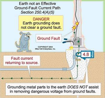

That is not right. If the hot wire touches the ground, there will be a somewhat exciting spark (I have some melted screwdrivers to prove it) and a rush of current from the hot wire to the ground. If a circuit breaker or other protection device does not open, things will explode, melt, catch on fire. If you happen to be part of that path to ground, you will receive a dangerous, perhaps lethal, electrical shock.
What you may be missing is that the Earth at the AC generator is not negative, it is zero. In a North American 60Hz 120 system, the hot wire is alternating between negative -170 and +170 (120 volts is the RMS average - google for "root mean square electrical power" for more), so there is a voltage difference from ground, and hence current flow in one direction or the other throughout the cycle.

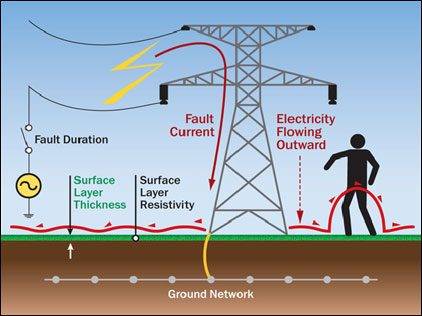

http://www.esgroundingsolutions.com/about-electrical-grounding/what-is-step-and-touch-potential.php
Likes jim hardy

Don - you taught me that nuance of term "Step Voltage".

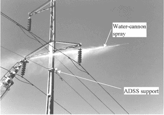

We tried an insulator wash system that used the principle of breaking the stream into droplets separated by enough distance to prevent conduction..
It worked okay the first couple of times... wish i had a video of that 240KV flashover

I've heard of power line insulators washing systems where they use water spray under high pressures. Water is of low conductivity or even tap water.
Sounds insane but...
Very pure water is a good insulator. Some generator windings are water cooled.
I've heard of success washing insulators on transmission lines. Our trial on a transformer didn't work out well.
System was the same used for washing insulators on transmission lines? Maybe it was used in a wrong way...
Maybe. It was one of the earliest offerings. I see it's still done a lot of places.
On a high line like that there's nothing immediately below the insulator, so runoff falls and separates.

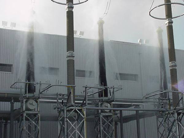

I'd be doggone nervous around this:
Our failure was on a transformer with vertical insulators like these.

The neutral of the secondary is grounded just like the neutral is grounded in a house panel. The only thing going thru here is perhaps a small trickle current, a perhaps a ground fault or things of that nature.
When the secondary of transformer gets disconnected, the primary sees an open circuit and NO power flows.
Why, because the neutral of the transformer has a potential of zero volts...and the Earth ground has the potential of zero volts. Zero minus zero is...Zero. Therefore, according to V=IR, Zero current flows.
Hypothetically speaking, read the voltage in your house receptacles with a meter. Hot to neutral or hot to ground you get 120 volts. Now measure the voltage from neutral to ground. You will get zero volts. Same thing for 3 phase panel, neutral to ground is zero volts...same thing for said transformer above.
To answer the question about what happens when hot wire touches ground...again, we'll use our friendly V=IR. The current will simply be the supply voltage divided by the resistance of the ground back to the neutral of the panel, or the neutral of the secondary of its transformer. Or a combination of both would be even more realistic. Both of these neutrals are obviously tied to ground.

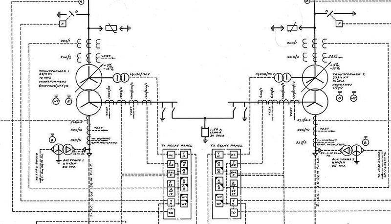

K. I guess I must be misunderstanding something. This is how I've always visualized how high voltage (power line) transformers (7 kV, 36 kV, 500 kV, etc...) are hooked up. Am I wrong?
you missed the connection from the other side of the generator ... as shown, the circuit is incomplete
transmission circuits don't have a return (neutral) wire. so it must go to ground.
also... neutral wires on distribution circuits are connected to ground at poles so it never makes it back to the substation.
in either case, the circuit never makes it back to the source.

Current flowing through the Earth (unless it is SWER) is, by defintion, fault current.
Transmission and distribution circuits employ sophisticated protection systems to detect Earth currents and disconnect the circuit when they arise.

Where the neutral-earth is physically earthed in multiple places (be it a link box or a pole) this is known as protective multiple earthing.
The fault circuit certainly DOES include the Earth point (star-point of transformer or a earthing resistor) at the substation.

@William White
In the distribution transformer I've seen the primary seems a delta. So there is no point to attach a neutral right?
Even in utility pylons I see wires in groups of 3 (plus the protective ground on top for lightning strikes). So those are three phases with no neutral correct?
What you seem to be describing with the SWER use-case is the final distribution leg. But high voltage transmission seems mostly without a separate neutral conductor, correct?

However, (at least this is the case in the UK, (mandated by law) and I can't see it being different anywhere else) there must be an earthed reference point at every voltage level. So if your transformer primary (say 11kV) is delta wound, then this will be connected to a transformer that is either star (or sometimes zigzag) wound to provide an Earth point so the 11KV circuits are earthed.
Say you were looking at an 11kV/400V TX where the HV side of the TX is delta wound. The HV windings would be connected to power lines that go off somewhere to a 33/11kv TX where the 11kV winding is star. So your distribution/transmission circuit can - and usually will - contain a mixture of star/delta; delta/star; and star/star transformers (and possibly some zigzags) at each voltage level.
ie. you might have a sequence of transformers in your system:
400V (star) / 11KV (delta)
connected to
11 KV (star) / 33 KV (star)
connected to
33 KV (delta) / 132 KV (star)
connected to
132 KV (delta) / 400 KV (star)
so at each voltage level, 400V, 11KV, 33KV, 132KV, 400KV there is a star point for earthing. Here the 11/33 is a star-star TX which is quite common.All of this is three wire except the 400V distribtion network which is four-wire so customers are provided with 230V single phase. (the voltage levels obviously vary by country).
