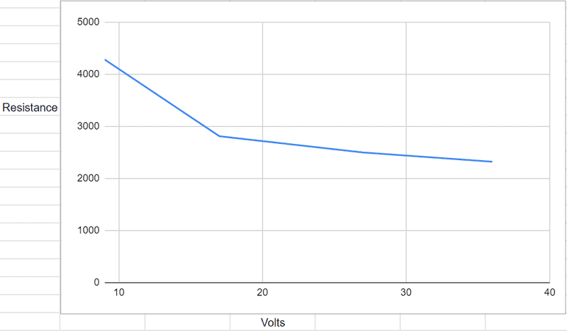

What happens to resistance of tap water as voltage is increased?
In summary, the speaker did a series of experiments measuring the current of water at different voltages and observed a decrease in resistance at 9-18 volts, but a smaller decrease at 27 volts and even less at 36 volts. They are curious to know why this trend occurs and if it continues at higher voltages. They also mention using electrodes and ask if the water is distilled or salty. The responder suggests that the rise in resistance could be due to gas produced by electrolysis reducing contact with the electrodes. They also mention using AC instead of DC to prevent polarization of the electrodes and warn that using high voltages could result in the water boiling violently and potentially destroying the experiment. They suggest using carbon electrodes to avoid dissolving metal and inquire
kma
28
In recent days I have done a few experiments measuring the current of water as it goes up from 9 volts up to 36 volts, and following Ohms law to convert it to resistance. And I discovered a very interesting trend. In between 9 and 18 volts, there is a massive drop in resistance (by around a 40% reduction) but then as I go up to 27 volts, its a 5% reduction, and is even less of a reduction when reaching 36 volts. I've done this experiment a few times and this has continued to happen. This is it visualised on a graph;
I am curious to know why this happens, why there seems to be a reduction as I go from 9 to 18 volts, yet the reduction seems to reduce at 27 volts and reduce further at 36. Is there a reason that? And as I go further up the voltages (don't want to test with higher), does this continue with the reduction in resistance continuously reducing, and if not at what voltage does it change?
Specifically I kinda want to know what resistance can I expect at around 240 volts

The rise in resistance could be because the area of the electrode in contact with the water is reduced by the gas produced by electrolysis of the water.
Is the water distilled, or salty ?
Are the electrodes carbon or metallic ?
What shape are the electrodes ?
Did you use DC or AC ?
You will need to use AC to prevent polarisation of the electrodes.

Zero, then infinite. The water will boil violently to produce high pressure steam. That will probably destroy your experiment.

Thanks for the response, have a few questions and answers on what you said.
'The rise in resistance could be because the area of the electrode in contact with the water is reduced by the gas produced by electrolysis of the water.' The resistance did not rise, more it reduced, are you saying there was more gas reducing contact at lower voltages?
'Is the water distilled, or salty ?' It's tap water, so its not distilled
'Are the electrodes carbon or metallic ?' I am using metal probes connected to a multimeter
'Did you use DC or AC ?' DC, how can i do this experiment with AC, anything I need for that?
'Zero, then infinite. The water will boil violently to produce high pressure steam. That will probably destroy your experiment.' How would this momentarily result in zero resistance? Is there a way to stop that boiling happening so I can get a reading, and if so what resistance would I get
No. The rate of fall was reduced at higher voltages, when higher currents would flow and more gas would be produced.

You are stripping metal from one electrode and plating metal onto the other. You must use carbon for the electrodes to avoid dissolving the metals.
Because you use DC, the system will always push an ion one way. If you used AC, current, the system would recover and show different electrical properties. I don't know why you are doing the experiment, so I cannot say if you should use AC or DC.

If you subject the water to a high voltage, what will limit the current ?
Surely you know that high voltages and water do not meet safely.

Wouldn't the water's resistance limit the current still? And how do i obtain an AC electrode that uses carbon? Also I don't see gas bubbles in the experiment
Do you understand electrolysis ?
https://en.wikipedia.org/wiki/Electrolysis_of_water
Do you understand that the resistance will depend on what species of chemicals are in the water ?
Do you also understand that the resistance will depend on the size and shape of the electrodes that form the cell ?

Yes I am. And when you are talking about there being no resistance at higher voltages, are you referring to the dielectric breakdown of the water where I believe there's a certain voltage where the resistance no longer works? Also (I'm not as knowledgeable about this which is part of the reason I am asking this question) if its gas bubbles resulting in the rate of fall being reduced, would the gas produced result in the reading being unstable (it was pretty stable in the experiment i did). Also a similar resistance trajectory happened when I tested something that was wet where there's no space for gas bubbles to form?...
I think first you should find out why you did not notice the gas bubbles forming on the electrodes. Is there something wrong ?
Then maybe you can describe the voltage source you are using, and how you measure the cell current and voltage.
Next, describe the geometry and size of the cell, the electrode material and dimensions.
It may then be possible to answer some of your questions.
