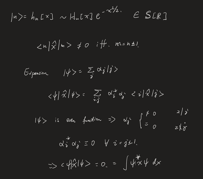

gaiussheh said:
I mean, QM always wants to pick a subspace of the Hilbert space such that an operator always maps a square-integrable function to a square-integrable function. Why is this necessary?
It is not necessary. What is actually necessary is that the operator is self-adjoint.
gaiussheh said:
I can always compute ##\displaystyle \int \psi^*[x] x \psi[x] \mathrm{d} x##, however if ##\psi## is not in the domain then since ##x |\psi\rangle## is not a vector in the Hilbert space the inner product ##\langle \psi | x |\psi \rangle## is not readily defined, but can only be seen as a short-hand notation of the former?
My guess is that the inner product ##\langle \psi | x |\psi \rangle## can be defined on the space of square integrable functions (i.e. ##L^2##), but I would have to look-up the details. (And if the integral should happen to be defined too, then one should be able to show that its value coincides with that definition.) The operator ##x## itself can be defined on the space of tempered distributions by transposition, whenever the operator ##x## is defined on the Schwartz space. (And it is precisely for that case that I believe that your inner product can be defined on ##L^2##.)
The problem with functions like the one in the OP is that the inner product involving the operator ##\hat x ^2## is not defined (even if the integral is finite for the operator ##\hat x##). This is why the function must eventually decay like a Gaussian - i.e. faster than any power of ##x##.
Eventually the mathematical theory that supports QM gets murky and goes beyond what would be taught in a linear algebra/functional analysis class. All I was really trying to say, however, is that the initial lesson to learn is that not all functions in ##L^2## are possible wavefunctions and we must be dealing with a subspace of ##L^2##. Not least, because there are "pathological" functions in ##L^2## that would not submit to much of the theory of QM. This is true of physics more generally - it can assume that functions are "well-behaved" - and anything else can be excluded on the grounds of being "unphysical".

It ensures that the inner product that you need to compute is finite by Cauchy-Schwartz. It is also needed if you want to do more than one measurement in succession . If the image of the ket is not another ket, how do you apply an operator to it!
This is a good argument why my guess that the inner product ##\langle \psi | x |\psi \rangle## can be defined on the space of square integrable functions (in the sense I had in mind) is wrong.
To confirm this, I also tried to look-up that stuff in the lecture notes of the course where I learned that stuff in 1999 (in Chapitre III. La transformation de Fourier). It is not mentioned there, and the inner product doesn't seem to have the same "you can see and understand when it works and when it fails" properties like the convolution.
