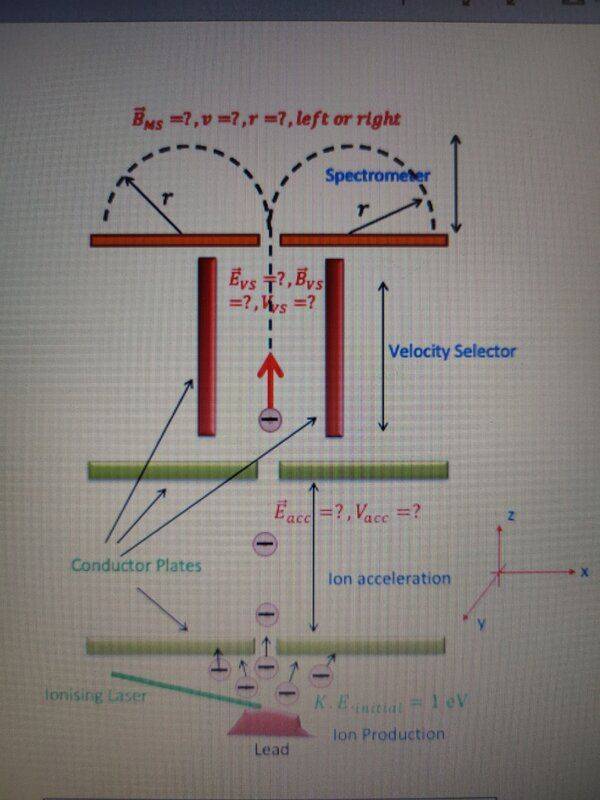

I try to do my assignment which is based on mass spectrometer entirely. The mass spectrometer i am working on has these parts below:
1.Accelerator region
2.Velocity selector region
3.Spectrometer
The elements i am working on are isotopes of the same element and they all enter the accelerator region with same 1eV kinetic energy.
My question is the energy that the ions gain during acceleration is same since they all have same charge. So the heavier isotopes will have smaller velocity and the lighter will have greater velocity. But velocity selector let pass only the ions with certain velocity. So how the spectrometer detects the other isotope ions? I am so confused about that. Thanks in advance.

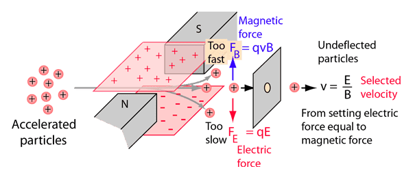

A velocity selector consists of a magnetic field and an electric field perpendicular to each other, like so:
In order for an ion to pass through, the magnetic force bust balance the electric force inside the velocity selector so that it doesn't accelerate sideways! That means you have ##qvB = qE \implies v = \frac{E}{B}##. Hence by varying either the magnetic field or the electric field in that region, you can selectively choose ions with a specific velocity.
The accelerated particles, for any given accelerating voltage, have a range of velocities depending on the masses of the various isotopes. That means that the velocity selector only let's through one isotope (strictly, one m/z value) at a time!

I know i can vary the magnitude of magnetic and electric fields to choose the isotopes with a specified velocity. But the thing i am trying to understand i will never be able to pass all of the isotopes together since different isotopes will never have the specified velıcity under the same accelerator region conditions. My professor wants me to determine these accelerator conditions like voltage myself. So for example if i need particles with 10 m/s, for which isotope i will create the accelerator conditions.
The accelerator has a fixed potential difference across the plates, ##V##. As you correctly deduce, this means that the kinetic energy of all isotopes are equal when they leave the accelerator (and equal to ##qV##). That gives you ##\frac{1}{2}mv^2 = qV \implies v = \sqrt{\frac{2qV}{m}}##.
You will notice that isotopes of different masses ##m## will then have different velocities. This is where the velocity selector comes in! A specific combination of electric and magnetic field strengths permits ions of velocity ##\frac{E}{B}## to enter the detection region. This means that we can effectively consider each isotope one at a time (or more generally, ions with the same m/z value)!
You detect the m/z ratios of the ions by the distance from the aperture at which they land on the detector. You slowly vary the electric field or the magnetic field of the velocity selector, and when a certain isotope is allowed to pass through you will see a spike on the data logger plot, corresponding to that isotope.

Right, yes I see. These instructions are very confusing! Here's how I would approach it.
Suppose the accelerator has a voltage ##V = Ed## across it, then the ions leave with velocity ##v = \sqrt{\frac{2qV}{m}}##. This ion will land a distance $$d = 2r = 2\frac{mv}{Bq} = 2\frac{m}{Bq} \sqrt{\frac{2qV}{m}} = \frac{2}{B} \sqrt{\frac{2mV}{q}}$$ from the aperture, where ##B## is the magnitude of the magnetic field in the detector region.
If we suppose all ions are singly charged, you finally have that $$\frac{2}{B}\sqrt{\frac{2V}{q}}(\sqrt{m_1} - \sqrt{m_2}) \approx 1\text{cm}$$ Where ##m_1 = m_2 + m_n##, if ##m_n## is the mass of the neutron (and ##m_1## and ##m_2## are of two isotopes of the type of ion you are using, separated by one mass number unit). You will have to play around with some values for ##V## and ##B## to see what is reasonable.

@etotheipi Hello again! I made progress I think. But there is one thing again. At the beginnig of the assignment my proffessor indicated that " The number of ionized isotopes entering into the accelerator region corresponds to a 1 𝜇𝐴 ion current. ". When I try to solve problems 4 and 7 I read that the formula for power is P=VI where I is the current in the circuit. I don't know where to use the information proffessor gave me but the ions have nothing to do with circuit they just pass through the plates. Can you lighten me please ?
You can think of it like this. If an amount of charge ##dQ## passes through the accelerator, it has gained kinetic energy ##VdQ##. So the rate of change of kinetic energy, or the power, is ##V\frac{dQ}{dt} = IV##.
So if the voltage across the accelerating plates is ##V##, then the power transferred to the ions is ##(\text{10}^{-6}V) \text{W}##.

@etotheipi in one question the ions are perpendicular to the electric field and in the other they are parallel does this affect the power?
In the accelerator, the electric field does work on the ions so it makes sense to speak of the power. In the velocity selector, the electric field is orthogonal to the ions so it does no work, and the power is effectively zero.

@etotheipi when I reread the question while rewriting I get confused again since it says "What should be the power of the voltage supply". in velocity selector I found it zero since its perpendicular in accelerator region I found a value according to the my voltage and the current of ions given in the assignment. but since it says "power of the voltage supply" I imagine something like battery and if its power zero like in the velocity selector part how can it create an electric field ?
Perhaps it means the power of the battery connected across the solenoid? If the current through the solenoid is ##I##, the number of turns of radius ##r## and cross-sectional area ##A## is ##N##, and the resistivity is ##\rho##, then the total resistance of the solenoid is ##\frac{2\pi r N \rho}{A}## and the power dissipated in the solenoid (which equals the power in via the battery) is that multiplied by ##I## in the solenoid.
The electric field you can think of as being created by a capacitor; in a steady state no current flows, so no power is dissipated here.

No I was talking about the velocity selector region. In the accelerator region the power is just ##I_{acc}V_{acc}##
Likes TheGmc
Since the questions are identical I related the power of voltage supply with electric field again :/
You just have to be clear on the different parts of the problem. There is an electric field in the accelerator region, it does work on the ions and as such has a calculable power of ##I_{acc}V_{acc}##.
In the velocity selector region, there is a magnetic field and an electric field. Neither of these does work on the ions that pass through, so they transfer no power to the ions.
You might however want to analyse the circuits that produce the electric and magnetic fields in the velocity selector region. The magnetic field is produced by a solenoid; since we can work out the resistance of the solenoid, we can figure out the power dissipated in it assuming we know the current. The electric field is produced by a capacitor, which in a steady state has no current flowing across it and hence no power is dissipated in the capacitor circuit in steady state.
Finally you have the deflection/detection region, with another magnetic field. Again, if you wanted, you could calculate the power dissipated across the solenoid producing the magnetic field.
The questions your professor is asking are quite arbitrary, and my advice would be to just try and separate out all the different pieces and think about it as logically as you can.
