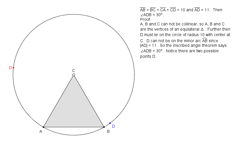

In a plane we have :$\overline {AB}=\overline {BC}=\overline {CA}=\overline {CD}=10$ and $\overline {AD}=11$
find :$\angle ADB=?$

johng said:
Simple solution:
very nice!
