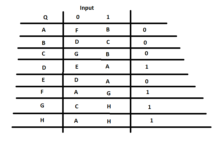

In the notes of computability theory, I found the following:
$$q \sim_0 q' (\text{ q, q' are 0-equivalent}) \Leftrightarrow \text{For each input, q,q' have the same output} $$
$$q \sim_k q' (\text{ q, q' are k-equivalent}) \Leftrightarrow \text{ q,q'are 0-equivalent and } \forall x \in \Sigma , \delta(q,x) \sim_{k-1} \delta(q',x)$$
We have the following:
$0$-equivalent: $\{ A,B,C,E\}, \{ D,F,G,H\}$
$1$-equivalnt: $\{ A,B,C,E\}, \{D\}, \{ F,G,H\}$
$2$-equivalent: $\{A,C\}, \{B,E\}, \{ D \}, \{ F,G,H\}$
$3$-equivalent: $\{A,C\}, \{B,E\}, \{ D \}, \{F,G,H \}$
Could you explain to me how we found the $k$-equivalent sets for $k \geq 1$ ?
How do we find the states $q, q'$ for which $\delta(q, x) \sim_{k-1} \delta(q',x)$ ?

What kind of finite automata are you talking about? What do the columns of the table mean?
Machines of finite states are meant. At the first column we have the states. At the two next columns we have the transitions and at the fourth column we have the output.
So the output depends only on the state and not on the input? I have not seen such automata before. It may be good to provide a definition in order to be sure.
States $q$ and $q'$ are considered 1-equivalent if both $\delta(q,0) \sim_0 \delta(q',0)$ and $\delta(q,1) \sim_0 \delta(q',1)$.
Let's take a look at $A$ and $B$.
We have $\delta(A,0)=F$ and $\delta(B,0)=D$.
We've already found that $F$ and $D$ are 0-equivalent, so $\delta(A,0) \sim_0 \delta(B,0)$.
Same for $\delta(A,1)=B \sim_0 C=\delta(B,1)$.
So $A \sim_1 B$.
Are $A$ and $C$ 1-equivalent?
And $D$ and $F$?
How about whether $A$ and $B$ are 2-equivalent?
We have that $\delta(A,0)=F$ and $\delta(C,0)=G$ and we know that $F \sim_0 G$. Also we have that $\delta(A,1)=B \sim_0 \delta(C,1)=B$.
So $A \sim_1 C$.
$\delta(D,0)=E \not\sim_0 \delta(F,0)=A$.
So $D$ and $F$ are not 1-equivalent.
$A$ and $B$ are not $2$-equivalent since $\delta(A,0) \not\sim_1 \delta(B,0)=D$.
We get the same set of states to be $2$- and $3$- equivalent.
Will the same sets be $k$-equivalent for any $k \geq 4$ ?

I mean the definition of the type of machines, not this particular machine. Something like "a finite automaton is a quintuple $(Q,\Sigma,\delta,q_0,F)$..." Otherwise there is a lack of clarity in the problem statement. For example, as I understand, ILS started answering without taking outputs into account at all.
It appears we can solve the problem without actually knowing what these outputs connected to states are, especially since evinda only asked for help when $k\ge 1$.
Those output states might mean anything. I'd like to interpret them as final states, which makes sense. Maybe it was something that got lost in translation? (Wondering)
Yes.
Since it didn't change in the last iteration, it won't change in another iteration. (Nod)
