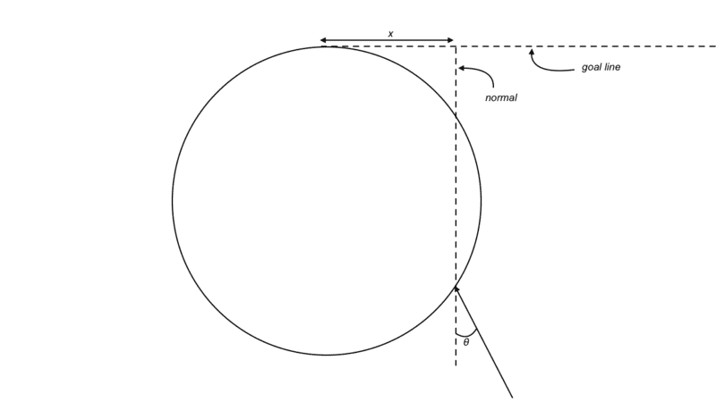

If you set theta to zero and increase x a bit (it is less than R/sqrt(2) in your example) it will make a glancing blow on the post and continue towards the goal line. It will be a goal if the other post is sufficiently far away.
I'll have to disagree on that one, I think the limiting case should look like this,

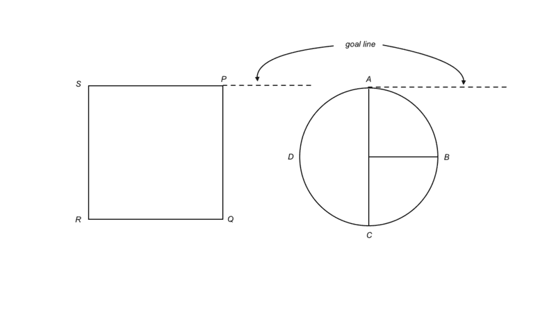

kshitij said:
Homework Statement:: Consider two shapes of goal posts, one with a circular cross-section and the other with square. Which of these posts have a greater probability of a shot hitting the post, go in?
Relevant Equations:: Laws of reflection
Limiting/critical incidence,
The critical value of angle of incidence happens when the reflected ray from the sector BC of one post hits the sector AB of the other post.

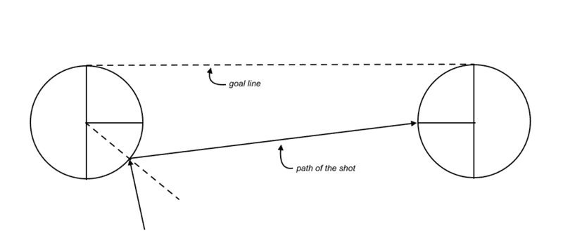

I said sufficiently far away. Make the other post further away and it goes in.
But even in your diagram, that is not quite the limiting case. It can hit the far post just below the mid point, then bounce back to the first post, just a little closer to the midpoint, then... you get the idea.
But the distances between the posts are fixed and finite.
If that's the case then it should eventually go in no matter where the ball strikes on sector BC? because it will keep bouncing between the posts till it gets closer to the midpoint of any post??

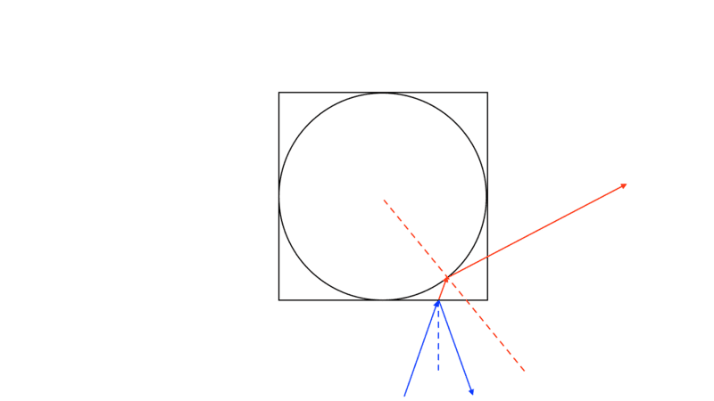

  • #57

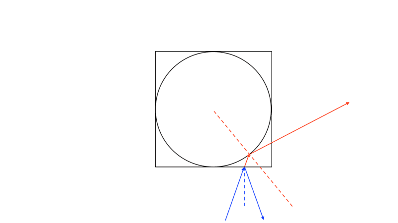

I don't think it works this way (see below, the blue lines are the path of the ball)
As you can see any ball striking below the midpoint of the far post, will never go in (as I suspected in the beginning)
  • #58

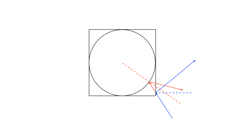

kshitij said:
But there are other possibilities like this one below,
Good point. Here we can clearly see that the blue path (square post) won't go in but the red (round) will go in. In fact there are some trajectories of this kind where a ball (even a full size ball) will enter the goal without contacting a round post that would collide with (the corner of) a square post.
This offsets the advantage of a square post for a shot from between the posts: whether it eliminates or even reverses that advantage depends on what weighting you place on each trajectory.

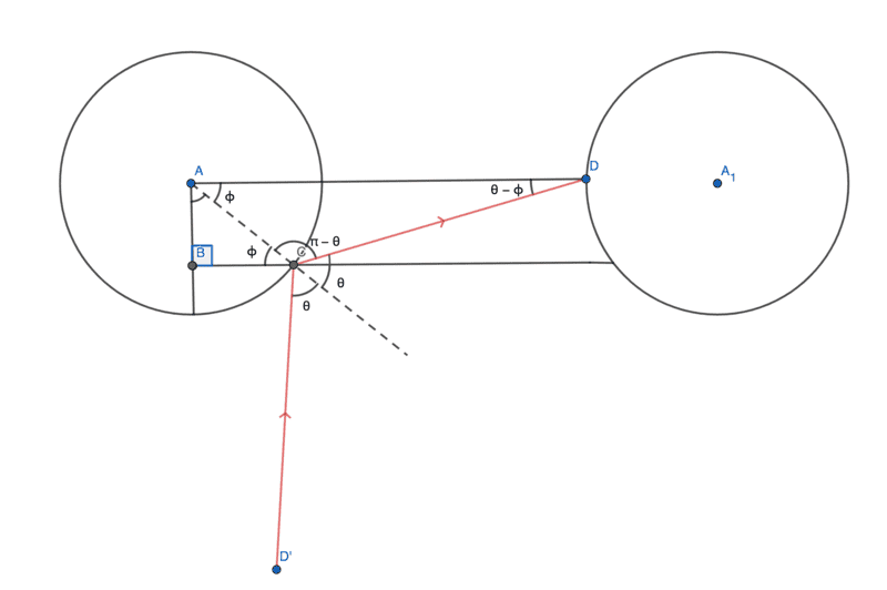

kshitij said:
Thus, I believe that this is the correct limiting case.
No. This is not the correct limiting case.
Here you have the ball striking the left hand goal post somewhere near the 45 degree line and rebounding into the right hand goal post exactly at it's 9 o'clock position. The ball will then continue, rebounding leftward at the same angle (##\Theta - \Phi##) above the horizontal as it arrived from below. That rebound angle is clearly more than good enough to score. You need a rebound angle that is only exactly good enough to score.
That is the limiting case of ##\theta## for any fixed value of ##\phi##

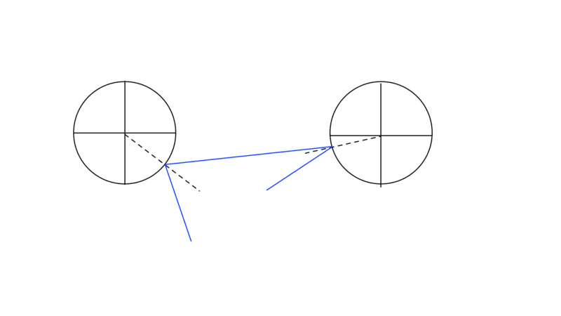

  • #75
haruspex said:
It is easiest to see it by running it in reverse.
Suppose the ball eventually hits the half way around point of one of the posts, but does so approaching from almost parallel to the goal line, making some tiny angle ##\alpha## to it.
Trace that back to its last bounce off the other post, and back again towards the first, and so on until it misses a post. Clearly, by making ##\alpha## small enough there is no limit to the number of bounces.
The algebra will be messy...
Edit: it goes like this. I'll describe it as though the ball starts at the halfway around point of one post and progressively bounces out of the goal.
Let the posts be 1, 2 and the distance between them along their line of centres, L, be D>>R.
From 1, it hits 2 roughly ##D\alpha## from L, at a point subtending angle ##\frac DR\alpha## to that line at the centre of 2.
It bounces from there at an angle ##(1+2\frac DR)\alpha## to L, do you see that?
Can you generalise it to n bounces?
So, I think this is the situation you are talking about (on decreasing the angle between the line joining the centres and path of the ball (red), number of bounces increases),
This infact, does contradict what I thought earlier the situation would be for a ball striking the far post below the midpoint,
But on closer inspection, I spotted a difference between the two,
We can quite clearly see that on extending the path of the ball, the red one passes above the centre, while the blue one passes below the centre.
So, I speculate this (below) might be the correct limiting case (feel free to correct me),
Here the path passes through the centre of the far post and on rebounding off the far post, the path of the ball retraces itself.
Am I getting it right this time?

  • #76
Now I don't think that there is any smaller value of ##\theta## possible for this given ##\phi## because anything smaller than this will bounce away from the goal side after hitting the far post. So, I think that if we do what @haruspex said,
From 1, it hits 2 roughly Dα from L, at a point subtending angle DRα to that line at the centre of 2.
It bounces from there at an angle (1+2DR)α to L, do you see that?
And generalise that to n bounces, (according to what I think) the (n-1)th (*penultimate) bounce will be when the extended path of the ball just passes through the centre of either of the posts. So, we both should get the same result through both the methods. Doing the reverse process though will be much more complicated, so I think that solving the above critical case is the way to do it.
(*by penultimate bounce what I mean is that, we cannot keep on bouncing back and forth between the posts forever, there must be a time when the ball rebounding off one post will not bounce back onto the other post, thus the second last bounce is the penultimate bounce which you can picture by simply reversing the green path in the above image)
Edit: I do realize that if D>>R then there will be no limit on the number of bounces, but D=7.32m & R=0.06m, so I think we can't say that D>>R

You've gone a bit too far the other way. You could increase theta a little and still not score a goal.
E.g. if after the second bounce it travels parallel to the line of centres then after the third it will be moving away from the goal line.
It needs to keep getting a bit closer to the goal line each bounce. In fact, the angle to the goal line must reduce by a factor a bit greater than 2 (about 2+R/D.)

It seems to me now that the wrong question is being asked. The probability of a goal depends also on the thickness of the posts.
If we say circular posts are radius R and square posts are of side 2S then the question becomes what the ratio of R to S should be to make them equal.
To evaluate that, we need to consider the range of displacement of the trajectory from the centre line (the to the centre of the post) to be ##\pm D## where ##D>\max\{R,S\sqrt 2\}##.
  • #91
Continuing that line ...
The centre of a post is at the origin. If square, the post has corners at ##(\pm S, \pm S)##. If circular , it is radius R.
The other post is at ##(-\infty,0)##, to avoid worrying about rebounds off both posts.
The ball approaches along a line making angle ##\theta## to the positive x axis. Its line would pass distance d to the right of the origin.
The angle is uniformly distributed in ##(0,\pi)##. d is uniformly distributed in (-D,D) where ##D>R ## and ## D>S\sqrt 2##.
1. Square post.
A goal is scored if and only if the ball passes to the right of ##(-D,D)##. That is, if ##d>S\sqrt 2\cos(\frac{\pi}4-\theta)##. The probability of a goal is therefore ##\frac 1{2D\pi}\int_0^\pi D-S\sqrt 2\cos(\frac{\pi}4-\theta)d\theta##.
2. Round post
Certainly it is a goal if d>R.
Suppose the ball strikes the post at ##(R,\theta+\alpha)## in polar coordinates. So ##d=R\sin(\alpha)##.
It will rebound at angle ##\theta+2\alpha## to the x axis. A goal will result if that exceeds ##\pi##, i.e. ##d>R\cos(\frac \theta 2)##.
The probability of a goal is therefore ##\frac 1{2D\pi}\int_0^\pi(D-R\cos(\frac\theta 2)).d\theta##.
For what relative R and S are those equal? I get R=S(!)
If we consider wide angle shots rare, we could take the integration range as ##(\pi/4,3\pi/4)##, say, giving ##S=2\sin(\pi/8)R##.
  • Love
Likes kshitij

Yes, but the thickness of posts are fixed, I wanted to know the probabilities for only the cases when ##L=2R## where ##L## is the side length of square post and ##R## is the radius of circular post.
haruspex said:
To evaluate that, we need to consider the range of displacement of the trajectory from the centre line (the to the centre of the post) to be ±D where D>max{R,S2}.
As I understand if ##D>\max\{R,S\sqrt 2\}## then why would the ball even hit the posts? Yes it would go in but I wanted to know the probability of a shot going in after it hits the post.
haruspex said:
A goal is scored if and only if the ball passes to the right of (−D,D). That is, if d>S2cos⁡(π4−θ).
I don't understand why you multiplied ##S\sqrt{2}## with ##\cos(\frac{\pi}{4}-\theta)##? Maybe a figure would help? If the ball passes to the right of ##(-D,D)## which is marked as point ##A## in the figure and I think that you assumed the other post to be at ##(-\infty,0)## then how will the ball ever cross the line?
I didn't understand how you got this but are you saying that both posts have equal probabilities? If yes then this was exactly what I wanted! but I am a bit surprised that the probabilities are equal
  • #95
Jan Jaroscak said:
That is actually a great idea! Instead of having to consider both the direction of the ball and the point of impact as varying factors like before, it is now possible to combine the two since the starting position will always be the same. In that case, am I correct in saying that the ball will end up in the goal when it reflects off the circular post anywhere to the right of the red ray in the diagram below? An example of this is the green ray. A ball (still assuming it is a point mass) traveling along the red ray would simply reflect in the same direction it came from as the ray is parallel to the normal. Any collision left of the red ray would cause the ball to reflect away from the goal line.
The red ray is definitely not the limiting case! the limiting case should be when the green line is tangent to the other post for no rebound by the second post and for only one rebound by the second post the green line should end up in the top left quarter of the second post.
  • #96

I wanted to know the probabilities for only the cases when L=2R where L is the side length of square post and R is the radius of circular post.
kshitij said:
if D>max{R,S2} then why would the ball even hit the posts?
To make a proper comparison, you must not only consider the cases where the ball hits the post. There will be trajectories that would hit the one post shape but not the other. So we must set D large enough to encompass both posts.
That's to the right from the ball's perspective, so to the left in the diagram.
For the distribution of trajectories I chose and equal widths of posts (L=2S=2R), yes - I was surprised too. But as noted, if you change the distribution the answer changes.

And how did you get ##d>S\sqrt 2\cos(\frac{\pi}4-\theta)##?
Also I hope that this diagram is now correct,
  • #99
Draw the trajectory passing through A=(-D,D).
If its nearest point to the origin, O, is B, what is angle BOA?
  • #100
Yes I get OB=##S\sqrt2\cos(\frac{\pi}{4}-\theta)##, next step?
