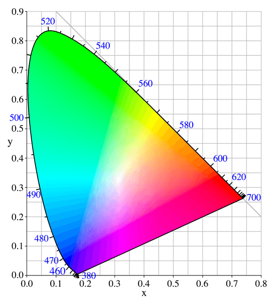

This is the question that you have been asking all along (in various terms). Your problem is one of definition and notation. Have you actually looked at the CIR colour diagram? How are colours specified on it? You will notice that it is a two dimensional graph so how, in the world, could you expect to be able to give the result of mixing a number of different coloured lights in terms of one number? You have been told several times, on this thread, that you cannot generate one wavelength of visible from two other wavelengths. You do not seem to have accepted that.
The wavelengths of the spectral colours are marked along the upper curve and they only refer to points on that actual curved line they are not like times on a clock face, that indicate the angle of the hands. None of the colours on a radius from White to a spectral colour, consist of just one wavelength of light. They are all produced by a mixture (desaturated) and many of them are named blue, green, yellow etc.. The large area of colour underneath the white point, represents perceived colours that do not relate to any spectral colour (single wavelength).
Virtually no one in the 'colour business' (artists, printers, TV directors, dye makers) concerns themselves with wavelength. They are interested in the colour that will be perceived by the viewer. What 'colour' would you call your favourite red jacket? It will be reflecting a significant amount of shorter visible wavelengths, too. If you insist that 'reds' can only be spectral then you jacket cannot be red.
Bear in mind that no one ever saw spectral red or green or yellow whilst the language of colour was developing, hundreds of years ago. It is only recently that the 'saturated' (pure spectral) colours were ever seen at all.
We're not talking about and "optical illusion"; we are talking about the normal way we perceive things. We can measure wavelength perfectly. We can predict, to some extent, what 'colour' a given combination of monochromatic light sources will be perceived as. But the perceived colour and the degree of agreement between different people cannot be predicted because the colour is in each or their heads.
I suggest you read all that - and what other people have written in the state of mind that will accept what is actually written and not insist on your particular interpretation of it. Saying you "don't understand" can sometimes imply that you "don't accept". I think that's what is happening. I strongly approve of your determination to get this stuff sorted in your head. You will get there if you just re-direct your efforts in the direction you are being pointed by the above posts.
