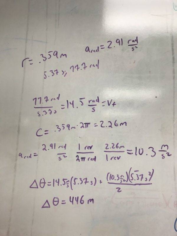

Per forum rules, please post your attempt.
Ive calculated delta theta, but since it’s not correct I cannot continue
What is this Δθ you are calculating? You are given the angle through which it rotates.
The linear distance
jdmaxwell02 said:
The linear distance
Well, that's an unusual choice of notation. It looks like a change in some angle.
You are overthinking this part of the question. What is the relationship between the angle a wheel rotates and the distance around the edge that a point on the circumference moves?
Wow, I really was.
θr= arc length
77.7 rad * .359 m= 27.9 m
jdmaxwell02 said:
Wow, I really was.
θr= arc length
Ok.
On to the next part.
