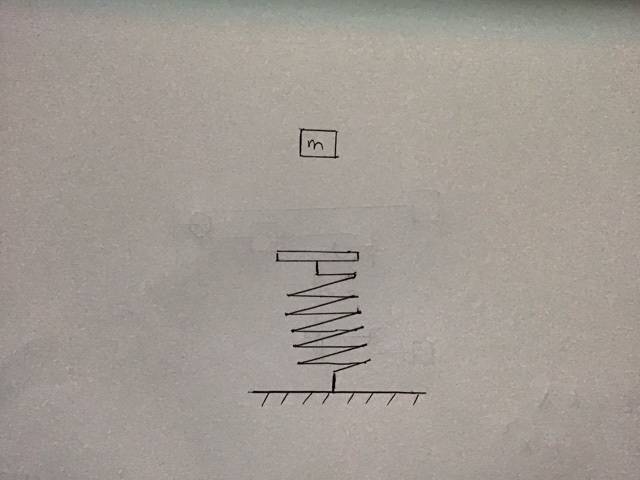

A mass of 1kg is dropped at a height of 6m on an ideal spring. Calculate the maximum spring displacement. Spring constant k=20N/m. Spring length is 5m.
F=kx
E= .5kx^2
the mass will drop 1 m before it comes in contact with the spring. I’m stuck afterward. Please help.
The total energy of 1 m is mgh= 1kgx9.8m/ss x 1m = 9.8J
9.8J = .5 x 20N/m x x^2 ---> x = .99 m
the spring is compressed by .99 m ?

Gravity does not switch off when the mass contacts the spring.
Thanks for the insight, so we must take gravity into account during the compression.
mg(1m) +mg(x) = .5k(x^2) ---> 0 = 10x^2 - 9.8x - 9.8
x=-.6; x = 1.6
So we take the positive one which is 1.6 m of spring compression? how can i double check this?

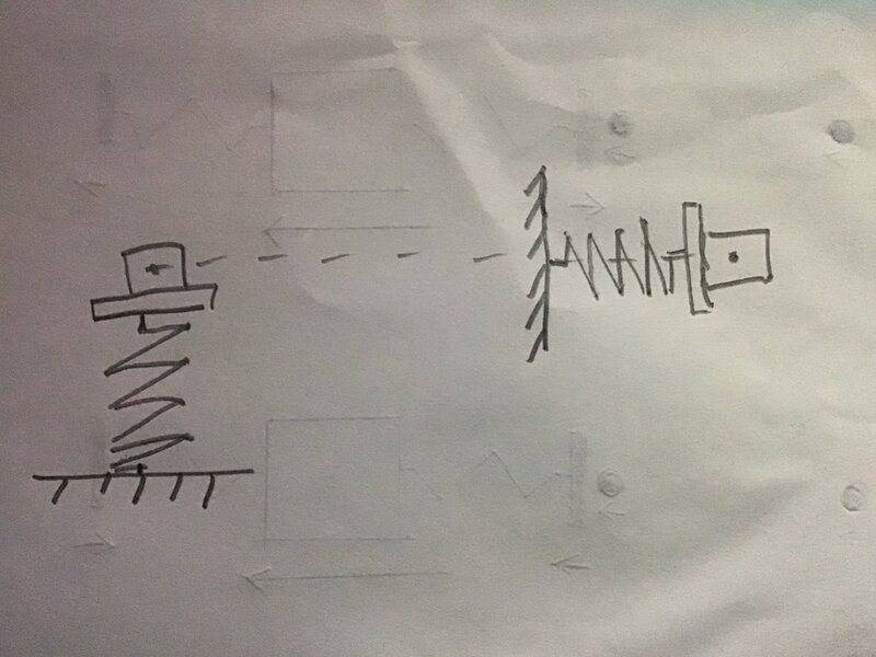

I don't feel comfortable about this answer. The solution should allows us to rotate the spring horizontally at maximum compression and it would yield the same result in term of energy. However, the horizontal position doesn't have a force of mg=10N pressing on it like the vertical position, so something is off. Thanks for helping though.
About what axis?
As the figure shown
leafy said:
As the figure shown
I assume you are taking the speed at contact as the same in both orientations. With that axis, the horizontal version does not have any vertical movement of the mass thereafter, so the energy is different.

There is the deformation of the vertical spring due to the dead weight of that mass (that will be the neutral point of any subsequent oscillation), let's call it ##h_{weight}##.
And then the deformation due to the velocity of the mass impacting it (that will be the lowest point of any subsequent oscillation), let's call it ##h_{impact}##.
Just before you turn the compressed spring sideways, what h does it have, ##h_{weight}## only or ##h_{weight}+h_{impact}##?
