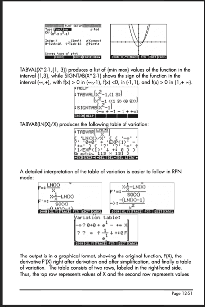

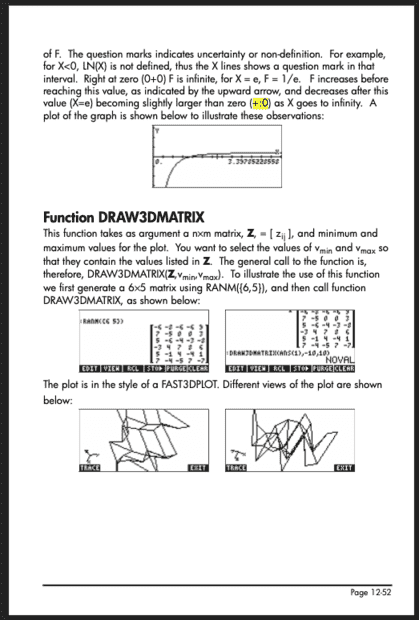

In hp 50g emulator, I performed this computation ## \lim\limits_{x\to\infty} [2^{2x} \times (\frac13)^x + (\frac12)^{2x}\times (\frac23)^x ]##
What is the meaning of +:0 ?
Did you try to estimate the answer ?

WMDhamnekar said:
Would you tell me on which page(page number), I shall get the information about +:0 ?
Can you make an effort yourself? I just suggested that the manual would contain the information you were looking for.
Have you computed limits on this calculator before? Have you tried a limit that you know what it should be?

I think the expression means you are approaching the limit from the right ( +:0 ) vs ( -:0 ) for approaching from the left.
As an aside, I searched for this +:0 using Google search (hp calculator +:0), and nothing came up. The "hp calculator" results superseded everything else.
Looking back in the manual provided by @malawi_glenn on page 11.2, I did find a reference to using +0 and -0 but not +:0 or -:0.
As a student or programmer, I wouldn't have guessed that usage from +0 or -0 in the manual.
I don't think that makes any sense, as the limit is as x approaches infinity. And per @malawi_glenn, the limit itself is infinity.
