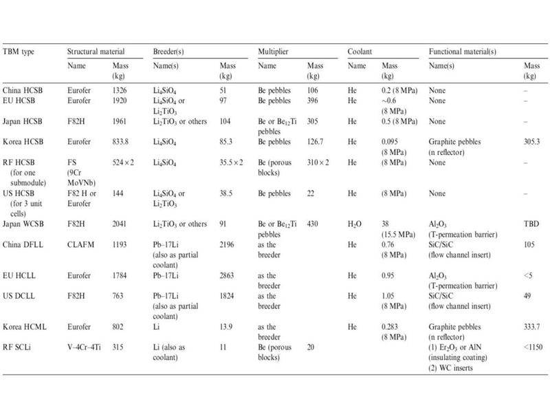

Objective/objectives?
Very difficult to fix threshold between scientific and engineering objectives but:
• achievement of 3000s of confinement time while previous experiments provide only about 1 second
• beryllium plated first wall.
• testing of various breeding concepts by changing of breeding modules.
• etc
In any case some technologies developing in ITER program's frame may be very useful for another programs.

Scientists don't know how to do tritium breeding, at least not anything close to the scale needed by the proposed DEMO project. They have some solid ideas, though. ITER is explicitly serving as a test bed for at least one of those ideas. How is this not meeting your objective for exploring these concepts? This is science at work. If researchers knew what they were doing they wouldn't call it research.
Hence my question; what is the scientific objective?
Stop the disingenuous arguments. Now.
ITER is not CERN. ITER's goal is not to delve into the inner workings of the universe. Its goals are rather explicit. You can find them on many websites. And those goals are scientific. They are goals of applied science and engineering. The borderline between applied science research and engineering research is very fuzzy, perhaps nonexistent. Engineering is applied science, after all.
Which one? The last time I asked the ITER press office, they said there were no extant plans for tritium breeding. There was the opportunity to include them, I was told, and I have read through some of the proposals made for tritium breeding blanket modules, but that made it implicit that it is a test bed for breeding, at that time of me asking. There may well have been an update in the meantime - do you have a link to the accepted proposal?
I don't understand the objection to asking for clarification on ITER objectives. Getting objectives right should be at the heart of The Scientific Method.
Is there anyone from ITER on the forum that can link to/say what these are?
As I know there in ITER for checking of various breeding approaches are something like slots in which various types of breeding modules can be inserted.
