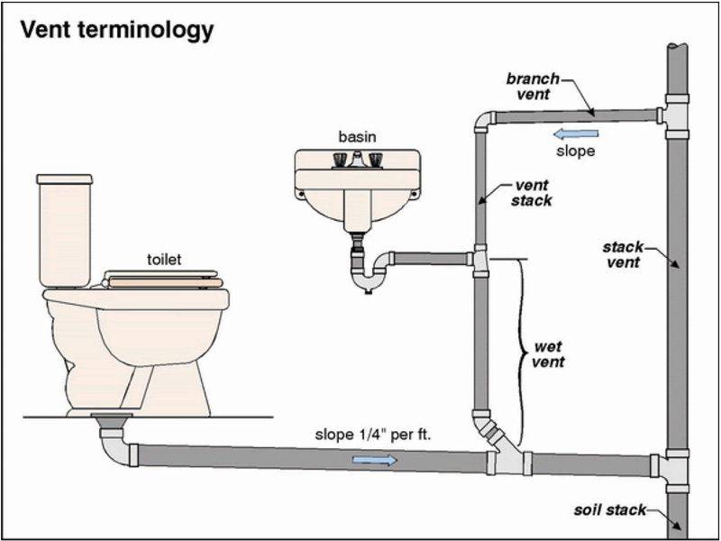

Are you absolutely sure that the sewage gases are coming up through the ground? There are other sources that are more likely. The most likely is a dry P trap. All plumbing fixtures have P traps. The diagram below shows a P trap under the basin, while the toilet has the trap built inside. The vent stack connects down to the soil stack which is connected to the sewer, and connects up to an open pipe above the roof. If a fixture is not used for a period of time, usually more than a month, the water in the trap evaporates and sewer gases enter the building. If you have any sinks, toilets, shower pans, or bathtubs that have not been used for some time, pour a quart of water into them and/or flush the toilet.
Another likely source is the stack vent on the roof. If you go onto the roof of any house and get close to a stack vent, you will notice a strong sewer gas odor. Air currents could be moving those gases to an air intake. It is good practice to check roof vent stacks to make sure they are not plugged with a dead bird or something.
Another source is the gasket under the toilet. Older toilet installations use a wax gasket between the toilet and the waste pipe. That gasket can leak. If the toilet moves when sitting on it, even a tiny little bit of rocking, then that gasket is leaking water out and sewer gas in. Be advised that a rocking toilet normally requires replacing the rotted wood that caused the rocking. A lesson I learned the hard way.
If it is an older house, there may be problems in the plumbing. My first house came with the toilet plumbed down to a tee in the sewer pipe. One branch of the tee flowed out to the city sewer, the other branch was underground and open. There was a root mass from under the foundation and ten feet into the pipe. The toilet worked better after I pulled out the root mass and plugged the opening in the tee.
Old style sewage piping was made of cast iron. The lead joint packing can leak.
