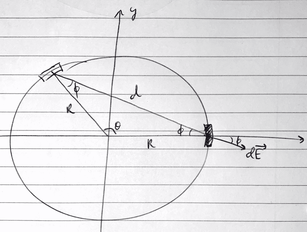

The ring I'll assume to have negligible thickness, and linear charge density ##\lambda##, as well as a radius ##R##.
N/A

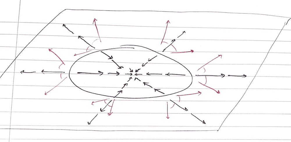

I tried considering a little piece of the ring (shaded black below) subtending angle ##d\theta##, and attempted to find the electric field in the vicinity of that piece by a summation of contributions from the rest of the ring:
$$dE_x = \frac{dq}{4\pi \epsilon_0 d^2} \cos{\phi} = \frac{\lambda R d\theta}{4\pi \epsilon_0 \cdot 2R^2(1-\cos{\theta})}\cos{\phi}$$ $$E_x = \int_0^{2\pi} \frac{\lambda \sin{\frac{\theta}{2}}}{8\pi \epsilon_0 R(1-\cos{\theta})} d\theta = \frac{\lambda}{8\pi \epsilon_0 R} \int_0^{2\pi} \frac{\sin{\frac{\theta}{2}}}{1-\cos{\theta}} d\theta $$ Problem is, that thing diverges because the denominator goes to zero at the boundaries (the indefinite is easy enough to solve by changing ##1-\cos{\theta} = 2\sin^2{\frac{\theta}{2}}##). If we call $$I = \int_{0}^{2\pi} \frac{\sin{\frac{\theta}{2}}}{1-\cos{\theta}} d\theta$$ then the electrostatic force on the piece in terms of this is $$F_e = (\lambda R d\theta) \frac{\lambda I}{8\pi \epsilon_0 R} = 2T\sin{\frac{d\theta}{2}} \approx T d\theta$$ and the tension would be, under the usual equilibrium constraint, $$T = \frac{\lambda^2 I}{8\pi \epsilon_0} = \frac{q^2 I}{32 \pi^3 R^2 \epsilon_0}$$but that doesn't make much sense if ##I## is infinite. I wondered if anyone could help out? Perhaps it is the case that the electric field diverges at the ring, but in that case, how could I modify my calculations to get a sensible answer? Because I am fairly sure that in reality the tension will not be infinite 😁. Thanks!
Likes Delta2 and Pi-is-3

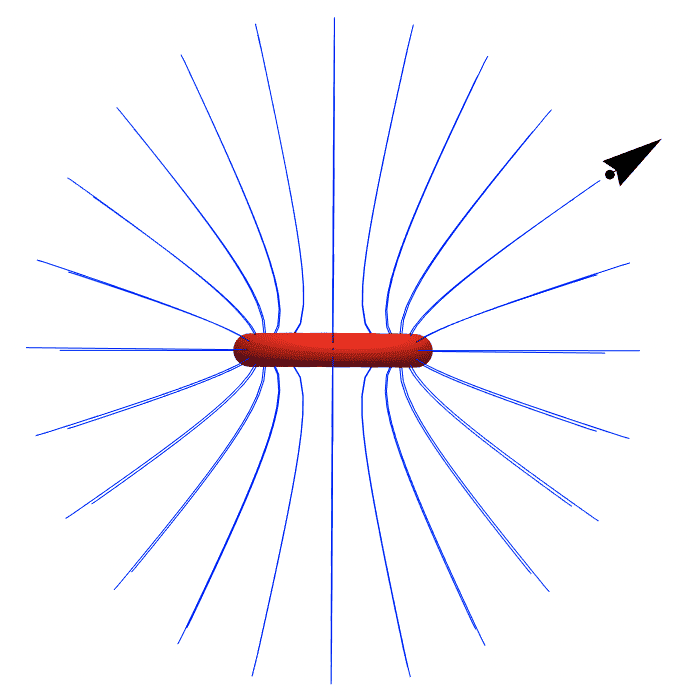

Delta2 said:
it will also diverge if ##R_{in}=R_{out}## which is the case that the torus degenerates to a circle.
Not necessarily. There are two limit processes here, that involved in the integration and that in letting the radius of the wire tend to zero. Swapping the order so that the integration is done first might not lead to the same result.
Likes etotheipi

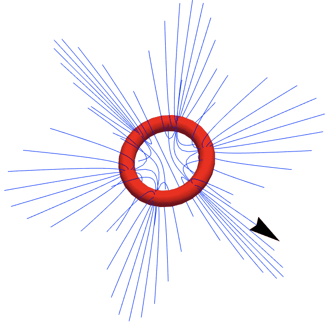

One thing that is coming to my mind constantly is if we have a steel wire (negligible thickness) then we know that it can stretched and tension can be developed in it by straining it. Now, imagine we charge the steel wire with continuous charge distribution, as all the charges are same they will repel each other and therefore we might be tempted to say there would exist a tension in the steel wire due to electric repulsion but when we go to mathematics for the calculation of repulsive force we find that charges are so close to each other that there will be an infinite repulsion on any segment of the wire.
So, how about first calculating the tension on a straight wire and then moving on to the circular loop.
We ll run into similar problem trying to calculate the tension in a straight wire of infinitesimal thickness. The reason is that by Gauss's law in differential form we ll have that $$\nabla\cdot\mathbf{E}=\frac{\rho}{\epsilon_0}$$ and because the wire is of infinitesimal thickness the charge density ##\rho## will be a dirac delta function $$\rho(\mathbf{r})=\lambda\delta(\mathbf{r}-\mathbf{r_0}),\mathbf{r_0}\in L$$, hence $$\nabla\cdot\mathbf{E(r_0)}=\infty$$.
I believe that infinite divergence of the E-field in this case means that the E-field becomes infinite. In some other cases it means that the E-field does a jump between two finite values.
Likes etotheipi and Adesh

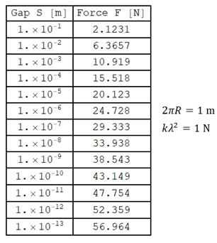

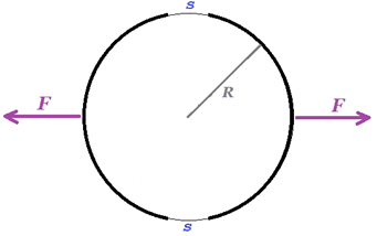

  • #32
Vanadium 50 said:
Natural length is irrelevant. I only look at energy differences. Don't make the problem harder than it has to be.
I think the energy of a spring is ##\frac{1}{2}k \delta^2 = \frac{1}{2}k(l-l_0)^2## so for an infinitesimal change in length ##dE = k(l-l_0)dl = k(2\pi r - l_0) \cdot 2\pi dr = 4\pi^2 k r dr - 2 \pi k l_0 dr##. The second term is dependent on the natural length, but you have dropped it.
Vanadium 50 said:
Did I talk about directions at all? You have a spring of one length and I change it's length, so I know how much energy it took. Don't make the problem harder than it has to be.
Then how did you calculate the tension? For a straight spring being extended, we could say that ##T dR = dE## if ##dR## is the displacement of the end of the spring, however in this scenario the tension is not obtained by dividing the increment in energy by the change in radius, because the tension forces doing the work are not in the radial direction?
Vanadium 50 said:
You aren't going to look at the proof, are you? You will see the proof relies on a lemma involving rings.
I have proved it myself earlier, and I did so by integrating up the electric field due to successive rings in the axial direction of those rings. What lemma are you referring to?
Vanadium 50 said:
When in 3D you use the shell theorem on a sphere, does its energy become infinite?
You want to use forces to solve this problem. You should energies.
I don't know what you mean; the self energy of a sphere can be obtained by integrating ##\int \frac{1}{2}\epsilon_0 E^2 dV## and it is not infinite.
I have thought about using energies but I cannot see a good way of doing so :smile:.
  • #33
True, but what does that term mean? It means that if there were no charge, that the ring was already under tension (or compression). The way I have defined it, the tension is zero if the charge density is zero. Had I got an answer like T = a + bλ2 (you see why it needs to be squared, right?) I would associate a with the initial tension. You shouldn't add in an extra "intrinsic" tension (or compression). Don't make this harder than it has to be.
