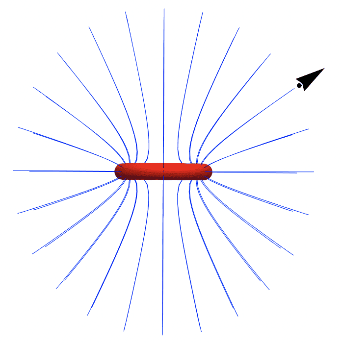

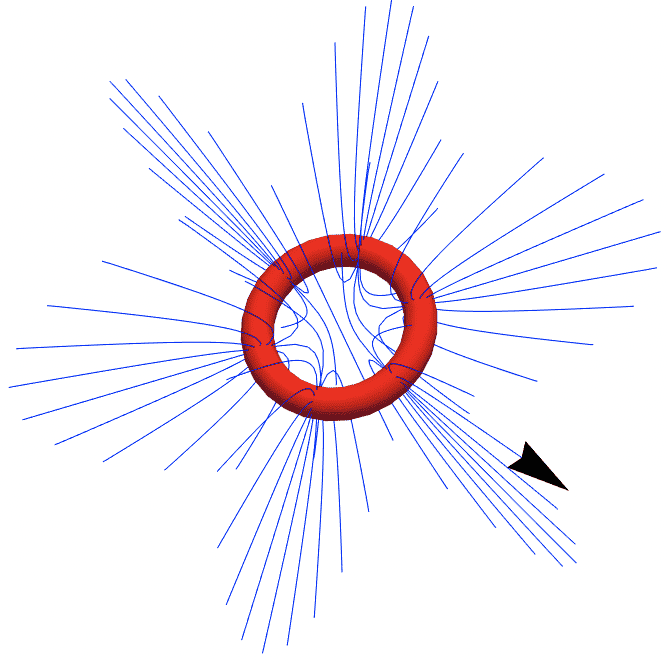

I downloaded this wolfram project and apparently this is what the electric field looks like around such a charged ring:
It looks like we can vaguely imagine various equipotential surfaces (easier on the left diagram) by tracing through perpendicular to the field lines, as a first "approximation" 😁.
Likes Delta2 and haruspex

View attachment 265446View attachment 265447
Yes, it dawned on me that in the vicinity of the ring the equipotentials will be toroidal shells around the ring.
Likes etotheipi

I think this is actually the problem. We are considering a ring embedded in a 3D space. As such, we must use Maxwell's equations in 3D. So it is impossible to "strictly work in a plane" in the sense of your heuristic argument with field lines.
As an example, here is my proof of the shell theorem. Take a spherically symmetric charge distribution, and a spherical surface ##S##. Then$$\int_S \vec{E} \cdot d\vec{A} = 4\pi r^2 E = \frac{Q}{\epsilon_0}$$hence the configuration is equivalent to a point charge at the origin. The key stipulation here was the spherical symmetry, since that allows us to remove the electric field from the integral i.e. it is of uniform magnitude across ##S##.
Now for a ring of charge, we can also surround it by a Gaussian surface and write $$\int_S \vec{E} \cdot d\vec{A} = \frac{Q}{\epsilon_0}$$except now we cannot deduce anything further because there is not sufficient symmetry. Although the flux/number of field lines ##\int_S \vec{E} \cdot d\vec{A}## is indeed constant however you choose your surface, that does not imply shell theorem for a ring, because we can no longer pull ##E## out of the integral: it is not of constant magnitude over ##S##!
In your terms, as you make the ring smaller and smaller, we are actually changing the distribution of field lines. We can thus infer nothing about the magnitude of the field strength outside the ring.
Which is what I explicitly said I was doing in #59.
I discussed this when I said 'People are, often implicitly, interpreting "negligible thickness" as "the ring is a torus, and we are taking the limit as the minor axis goes to zero.' As I pointed out then, doing this leads to infinities.
Let me point out that I am the only person who has actually been able to get to an answer to this problem.
The complaints fall into two categories. One is "you need to consider a finite extent of the ring (aka 3D vs 2D)" where my response has been that I am following the question as asked. It says "negligible" so I am neglecting it. (And would argue that not neglecting it when told to is a mistake) I have been very explicit about it. The other objection is that in a case with ambiguity ("inside" or "outside" of the ring) I pick the finite answer. I have been very explicit about that as well.
I've said all that I intend to say. This is the answer to the question posed. It is not an answer to any different question, even if that question is "better" or more realistic.
