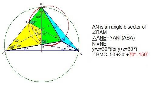

$\triangle ABC ,if \,\, \angle BAC=\angle ACB=50^o$
point $M$ is an inner point of $\triangle ABC ,$
given :$\angle MAC=10^o$ and $\angle MCA=30^o$
find the value of $\angle BMC=?$

my solution:
