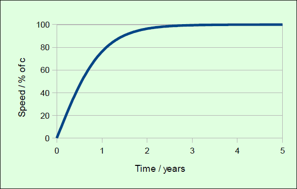

Yes, it keeps accelerating, but its speed will asymptotically approach the speed of light in a vacuum ("c"). This is described by Special Relativity. Here is a graph showing the speed of a rocket in space over time as it has a constant "1g" acceleration (9.81m/s^2):
https://commons.wikimedia.org/wiki/File:1gRocketGraph.png

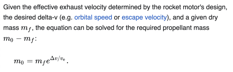

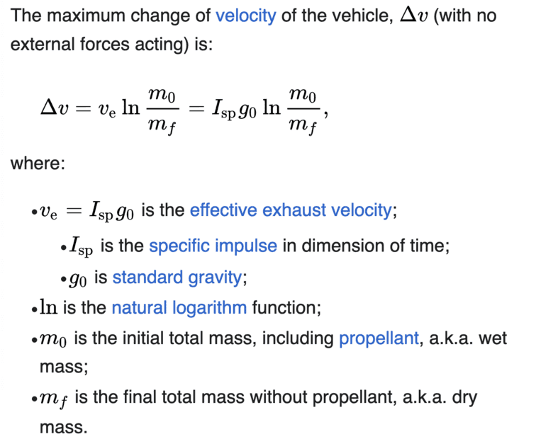

For a classical rocket the available speed ("delta V") can be modeled using the rocket equation. This mean the speed is limited by the total mass of propellant (the stuff the rocket ejects) relative to its total initial mass, as well as the effective speed of the ejected propellant relative to the rocket. For multi-stage rockets the equation become a "staged" version of the rocket equation.
