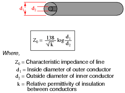

Now SophieCentaur can you tell me how the diameter of wire affects the speed of electromagnetic wave in it? at least using classical physics i don't see how one can arrive at this result.

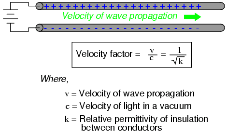

When i say bandwidth i mean the bandwidth in frequency range in Hertz, not the data transmission rate. To tell you the truth i am not sure how delays allow for better coding schemes with faster data rate, but this is not my interest here.
Yes the insulation affects the speed of the wave (which travels inside the wire as well, only the direction of travel is changing, from a direction say along the z-axis it becomes radial (speaking about a cylindrical wire)) BUT how the diameter of the wire (with or without the insulation) affects the speed of the wave?
The geometry of the conductors has an effect on the characteristic impedance of the transmission line. The idea here is to match the impedance of source and load for maximum transfer of power. The geometry of the conductors has no direct effect on the velocity of transmission.
It is the insulating material that affects the propagation velocity.

The simple answer is in two parts.
First, the speed of propagation of an electromagnetic wave is reduced when it travels through material. All electrical signals are waves, but normally the wave behavior of electricity can be ignored. In copper, the speed of an electromagnetic wave is reduced from 299,792,458 meters per second to 285,102,627. So the speed of the wave is reduced in the first place by the fact that it is traveling through a medium, but only by about 5%.
Second, the copper wire has non-zero impedance. That is to say that the copper wire has some resistance over its length, but more importantly due to self-inductance it also has reactance, the imaginary part of impedance (resistance is the real part) that can be thought of as something like a frequency-dependent resistance. The impedance increases as the frequency of the signal increases, and this means that for higher frequencies the amplitude is reduced and the phase of the signal is shifted, so it becomes harder to protect the signal from being degraded by background noise.
So it's not really the velocity of the propagating wave, ie its "speed", that's important, but rather the way that electrical conductors behave when they're carrying high-frequency signals. Limited frequency means that it's harder to send information as quickly.
