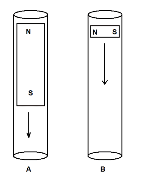

I'm desperately trying to figure out how that image relates to a bar or cylindrical magnet being dropped lengthways down a tube ??
It shows a magnet end on to some sort of "S" shaped surface. Doesn't really show a magnet going down a tube
So the point is ... how does the eddy current formation of the above image vary from the magnet in a tube scenario, where the
magnet sides are parallel ( not end) on to the tube
eg...
A Vs B ... your quoted image infers a B setup
My initial thought was the same as V50's
I would suggest that "A", is more stable as in "B" the magnet is more likely to want to tumbleDave
