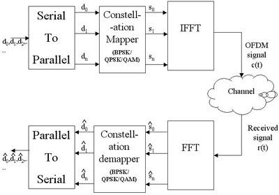

So even digital packets uses carrier waves?
Say I want to get data on a 100kHz wave and/or 50kHz, I sample it at 200kHz. Are you saying if there is noise on it, that looks like higher frequencies and we say 'no, that's not allowed so it must be noise'?

Ah,
Orthogonal frequency-division multiplexing"
interesting.

FFT typically is used to generate the modulation signal for the data input but the RF carrier modulation/demodulation in most modern digital systems use IQ in the transmit and receive paths in Software Define Radios (SDR).
Wifi uses Orthogonal frequency-division multiplexing". Many sub-channels (802.11 wifi uses 52), FFT is used to filter them.
